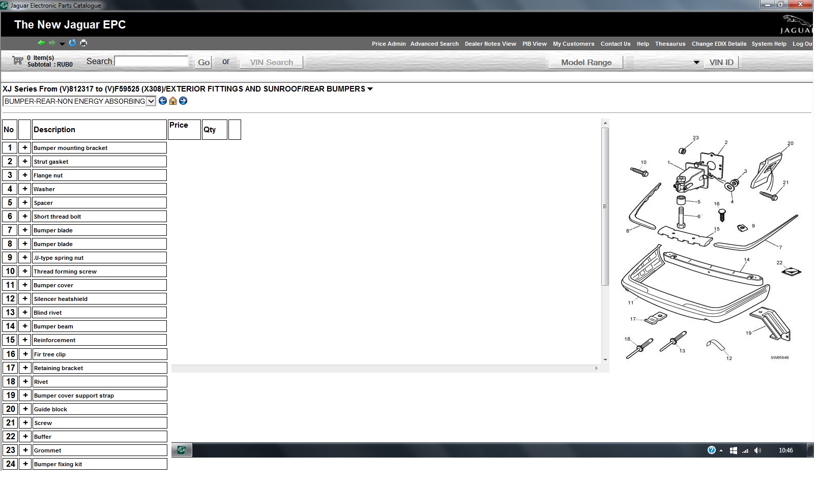

A UK spec vehicle so you don't have energy absorbing mounts.
Will it fall off? Almost certainly if you don't do something about it.
Does that mean it will be easy to dismantle? Almost certainly NOT. The bolt and spacer can often be almost welded to the bracket with corrosion. Fortunately the brackets are a fibreglass moulding which can be cut quite easily to avoid damaging the bumper
The Parts Catalogue drawing is better than the Workshop Manual for showing the general arrangement:
Use plenty of Coppaslip on reassembly.
