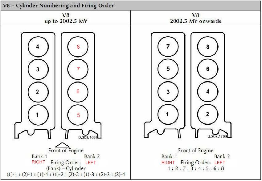

Engine numbers
5. 1
6. 2
7. 3
8. 4

Xalty, am I correct in that the 2002.5 my engines would still be x308 AJ27 engines, or are 2002.5 and beyond all x350 engines? Serial number would determine the cylinder number layout, correct? Interested because while I have an 01 XJR, I know it has a replacement engine thats newer than the car, but not sure of its date yet since I can't get a good look at the numbers on the side of the block yet. Just good info to know for potential future issues like misfires.
