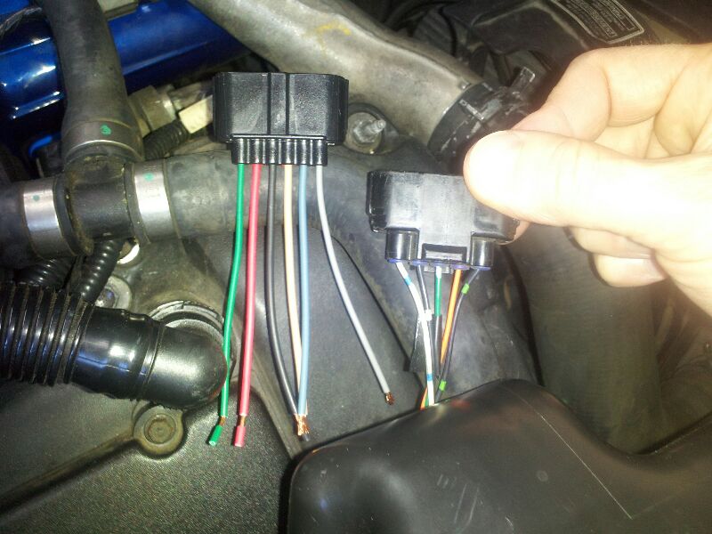

I have the 92mm/3.6" MAF from Pro-M
For me, I had to wire an independent IAT sensor, then all was fine.
The IAT sensor they supply is incorrect.
I just bought a spare complete 75mm MAF off ebay for $45 with shipping. I'd be happy to let you have it for the $45 I paid.
If you want to upgrade and get the Pro-M, you will need to wire the separate IAT sensor, I paid $74 for the sensor from Gaudin in Nevada for the one I am using.
I would recommend the 117mm over the 92mm though if you are going for max performance

so I need that IAT sensor?
