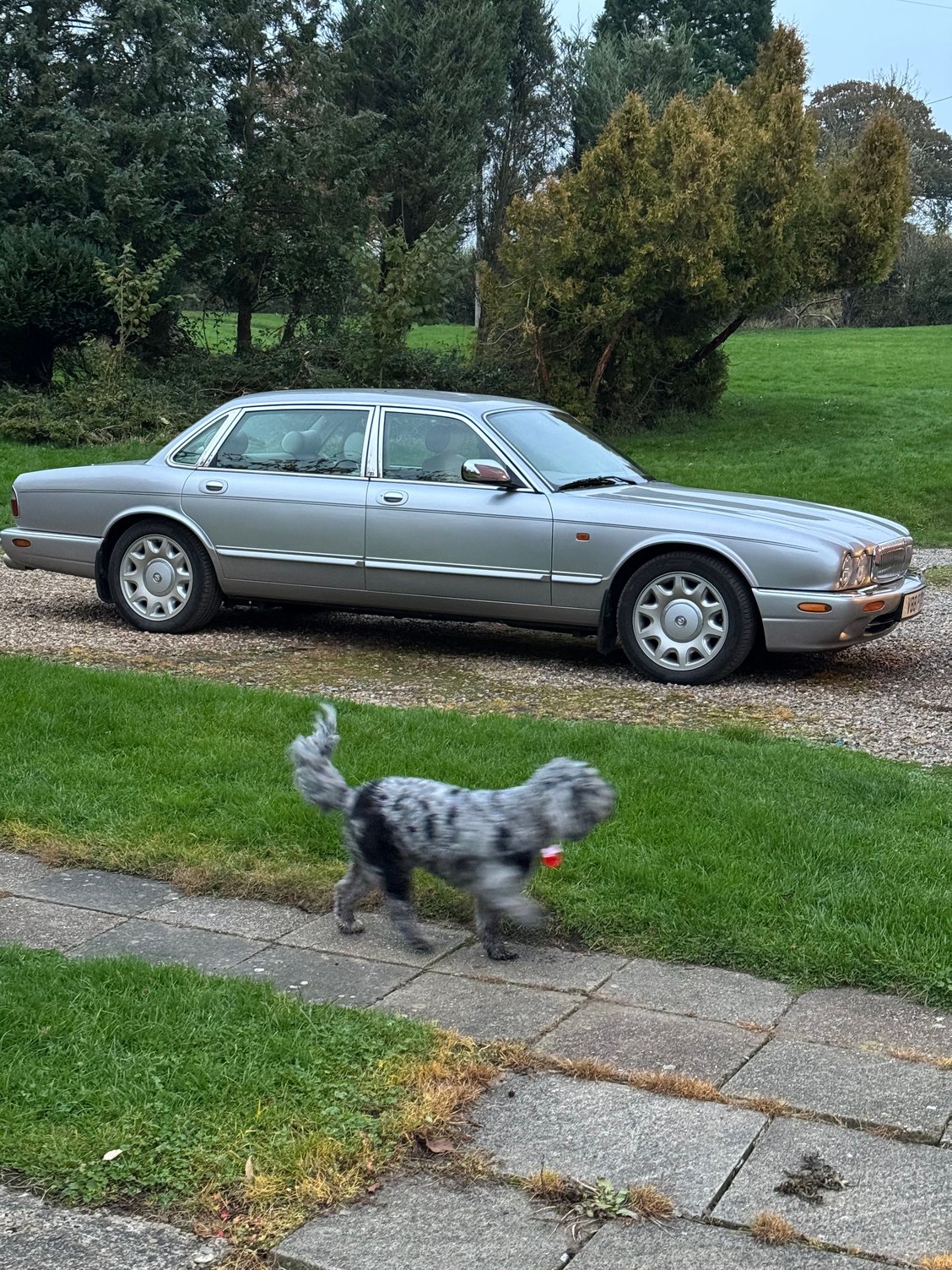

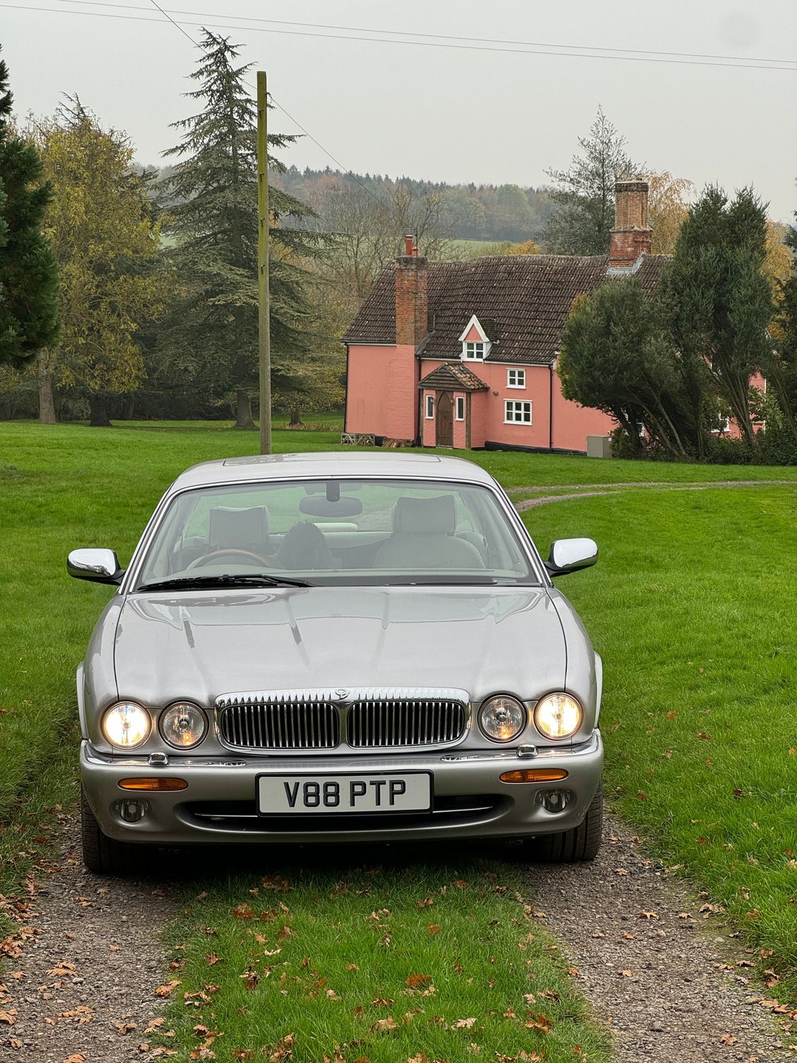

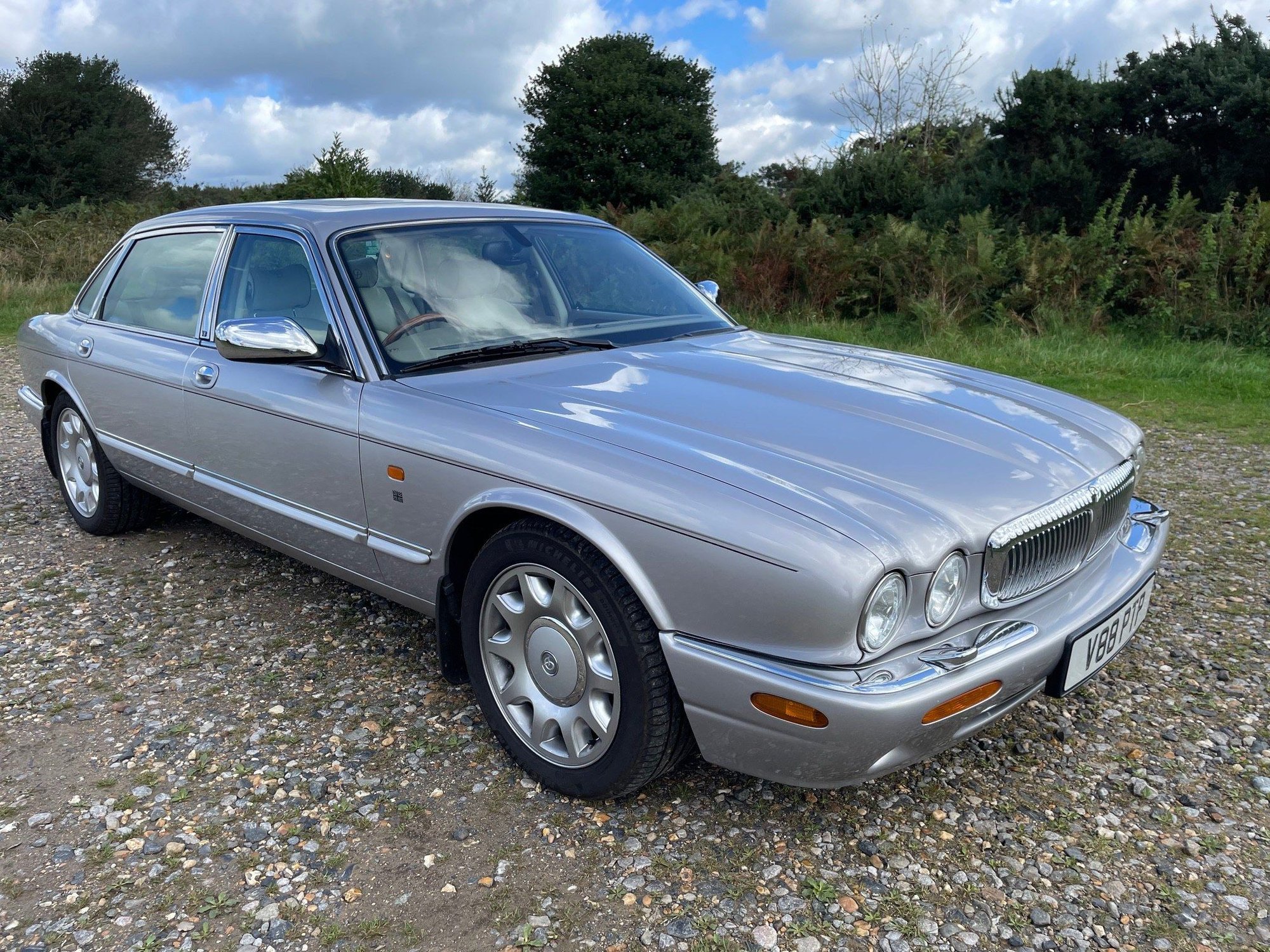

Hello Mark, I really love your thread. Having just accidentally (sort of lol) become the proud owner of a Daimler Super V8 I have only just discovered it. I normally live in the X300 forum, having owned a X306 (XJR) from 2019, but have now been searching in the X308 for any thread concerning the Daimler!
I have enjoyed reading it so much that it may have inspired me to start my own!
One thing I did note whilst reading yours, was that you had a full size spare wheel and wanted a space saver. I am the other way around. So I was wondering if you still had the full size wheel and if you do, would you consider selling it to me? I am based in SE London, but my wife would love a weekend in Liverpool to collect lol.
A couple of pictures of my new baby, which my wife has christened Shadowfax. Note, not our house but we holiday there in Suffolk a few times a year…
