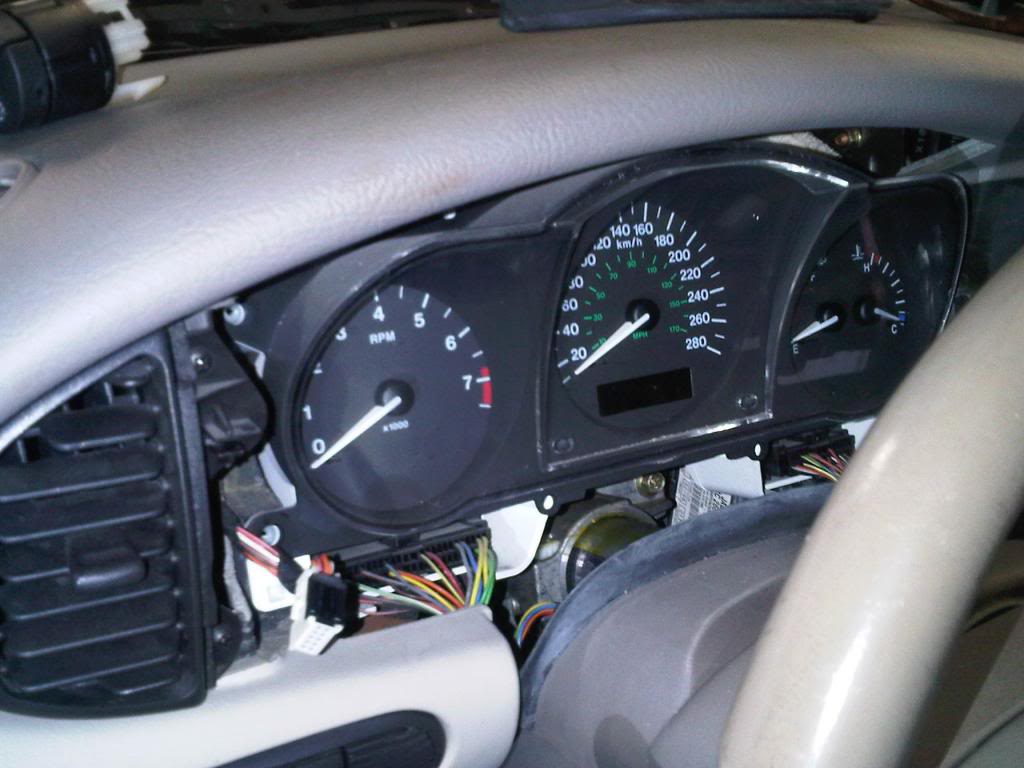

Four Philips screws later, the whole panel comes out.

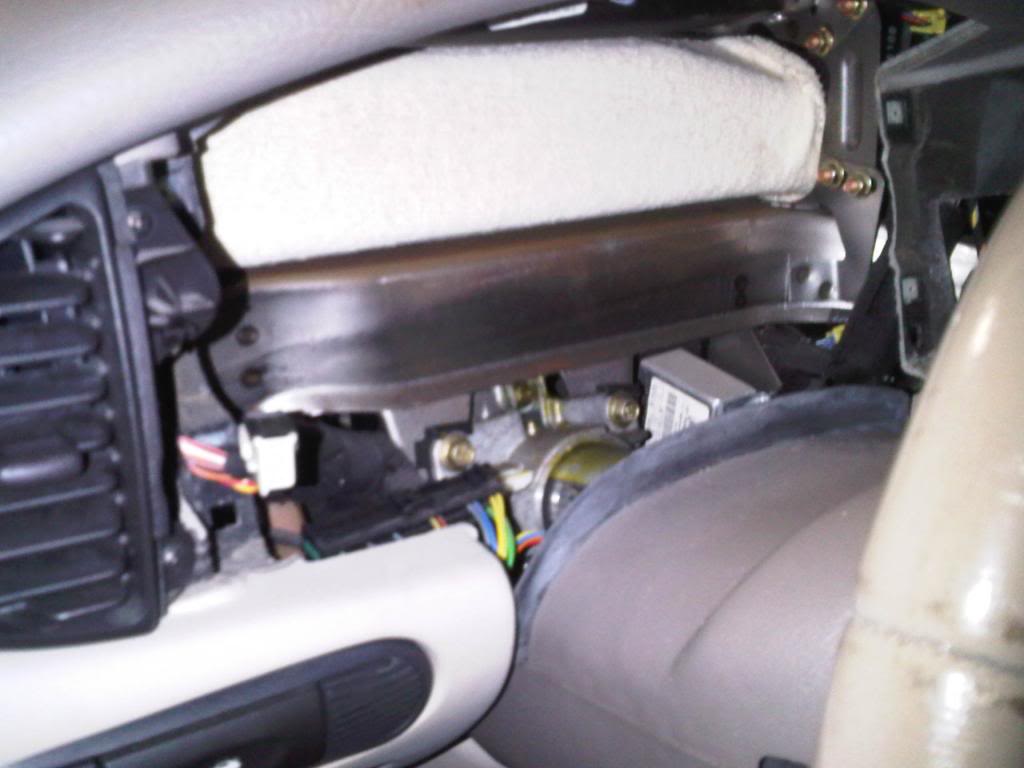

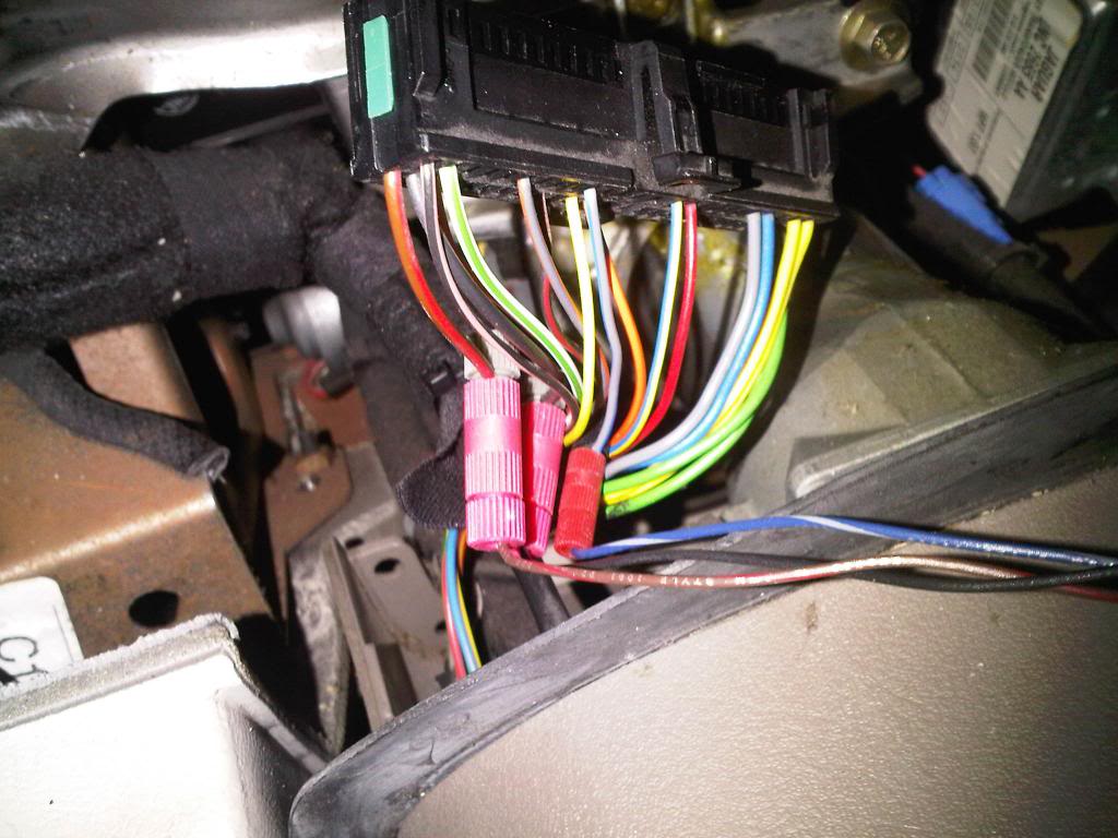

Next came the wiring in the car. Now here, I deviated a little bit from the instructions, and your experience may differ. I did open up the harnesses to get access, but found later that it wasn't quite as necessary as I first thought. I installed the splices closer to the plugs than recommended but it worked out for me.

Finding the wires to splice was easy, again, good instructions and pictures.
Now, lest you think I am in the employ of Jagwrangler, and am posting nothing but good news, here's my take.
I found the hardest part was splicing the wires. I am highly suspicious of any kind of wire tapping device, based on past experience. The Posi taps were fiddly, and more suited to smaller fingers than mine, perhaps!
But, I am forced to admit they did the job nicely, and they are way better than the junk I've seen in the past.
I found that propping the instruments on the steering column worked better than having them in the dash while splicing. After the splicing, it's a straightforward job to reassemble, then start the test procedure.

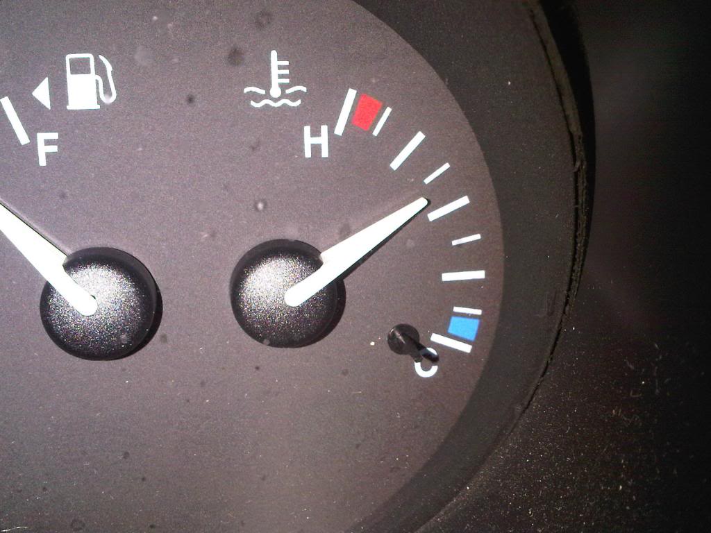

A little background on myself. I am an Aircraft Maintenance Engineer, specializing in Avionics, or the electronics and instrumentation side of things. All my career has been focused on making damn sure the instruments in the flight deck are calibrated and tested, indicating precise, accurate numbers.
Imagine my frustration with various car manufacturers who basically design their guages to lie and cheat! "don't worry your pretty little head, we know what you need to see on the dash, that's a good girl". Aargh!
Before I started this mod, I did my own tests to see what was displayed on the original gauge. Better minds than mine have done this, refer to the thread entitled "the folly of the temperature gauge". OregonJag did some great tests and posted a graph that lays it all out.
I'll add my own results, simplified. at 185 F, the needle is dead centre. It remains there up to 235 F! At 239 F, the needle then moves up a bit, seen here.
50 degrees of temperature change, and you don't have a clue! Thanks, Jaguar.

Full deflection and the red light does not occur until 245 F, way beyond what I'd want my engine to reach.
Anyway, after the install, I tested the accuracy using the OBD II, and it was bang on what Steve said it'd be. One thing that I could not do was the calibration procedure, since for some reason, my OBD will not read data unless the engine is running, and the cal feature only works with the engine off.
But like I said, I tested it and there wasn't any need to do the calibration anyway.
It's been a couple days and I haven't had a chance to see much variation in the temp, probably due to the cool fall temperatures of 3-5 degrees C.
Today I did see it above centre though, because I shut it down and started again a minute later after it heat soaked.
To sum up, this is a well built and designed product, with good features like an audible alarm. The install is pretty easy for pretty much anyone, and above all it works as advertised.
I now have peace of mind knowing that I have an accurate indication of what my cooling system is doing.

And a bit more info, since I am the **** retentive type and maybe a bit OCD when it comes to this stuff.
I was thinking about how it has behaved since the mod. Much to my dismay, it acts exactly the same! The needle goes to mid scale and stays there, pretty much.
Well I went back and tested it again. Yes, it's mid scale, because it's actually running at 185 F. At idle the fans come on and keep it at that temp. Revving the engine actually dropped it to 179 F and the needle moved to reflect that. It's nice to see a 6 degree change shown by the needle.
I then went and searched for an early post I did on thermostats, and found that mine is a 170 F thermostat because that's all I could get locally, even though 183 is "standard".
So there you have it. If anything interesting pops up I'll let you know.

I found that the needle on my temp gauge is higher on the scale with the RealGauge than it was before. I used the 185 marker for the middle of the temp gauge - that's where it used to sit, and now the needle sits about a tic mark higher at 200 F. But, I now know that this is the "real" temperature, and matches my OBDII readings. It is nice to have a real temp gauge.

This is consistant with what I have seen. A 170 degree thermostat typically gives a 185-190F running temperature. The standard 183F thermostat typically runs just over 200. Individual cars wil vary, but this is typical.
