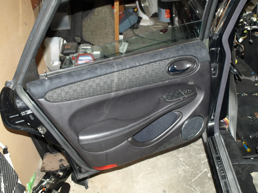

First thing was first, the XJR didnt come with the nice burlwood that the XJ8 and Vanden Plas did. It came with a dark green sort of wood that I personally found hideous. It had to go. I had 6 yards of black suede left from a previous project so i figured I would take care of a black headliner while I was at it. Pics will come soon of that. But I felt like doing a little more than not with this interior so the tops of the door cars and the dash were getting the suede treatment too.
Picture of the original door card.

Since I am also going to be doing my girls A4 interior trim in black gucci and couldnt think of anything else to redo the wood in, I ordered a couple extra yards to take care of my wood grain.
Picture of one rear door that is finished. Window switch trim is also recovered.

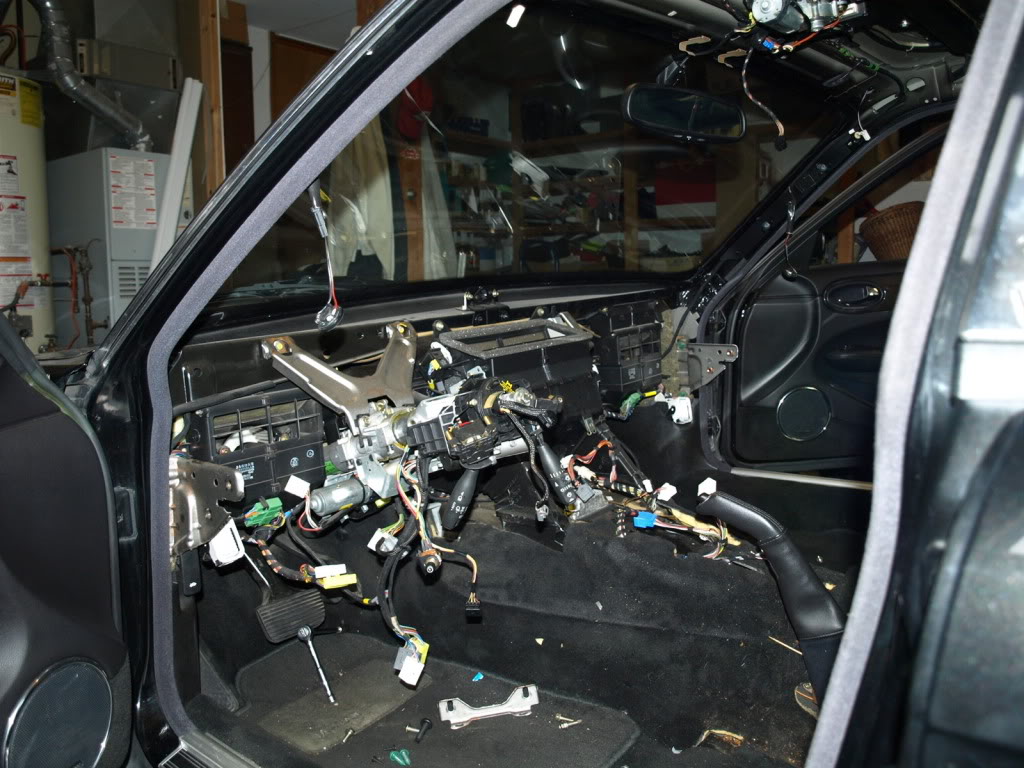

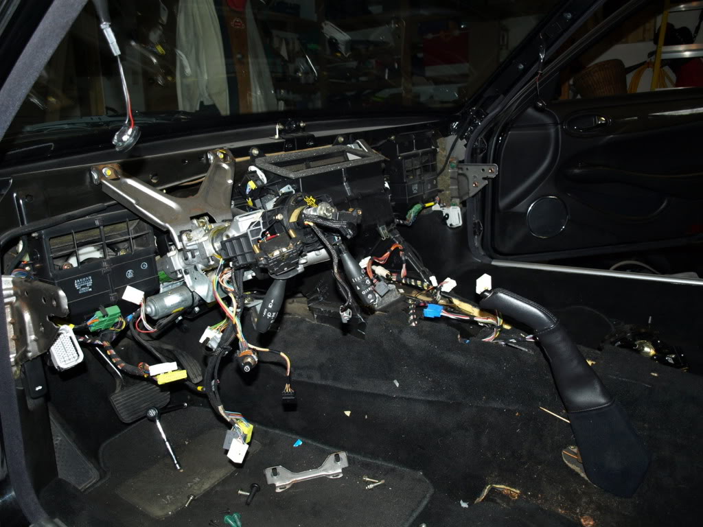

Word of advice if you arent a fan of headaches. Dont remove a dash from your x308... My mk4 GTI dash was cake and this thing made me want to stab kittens.
Dash out.

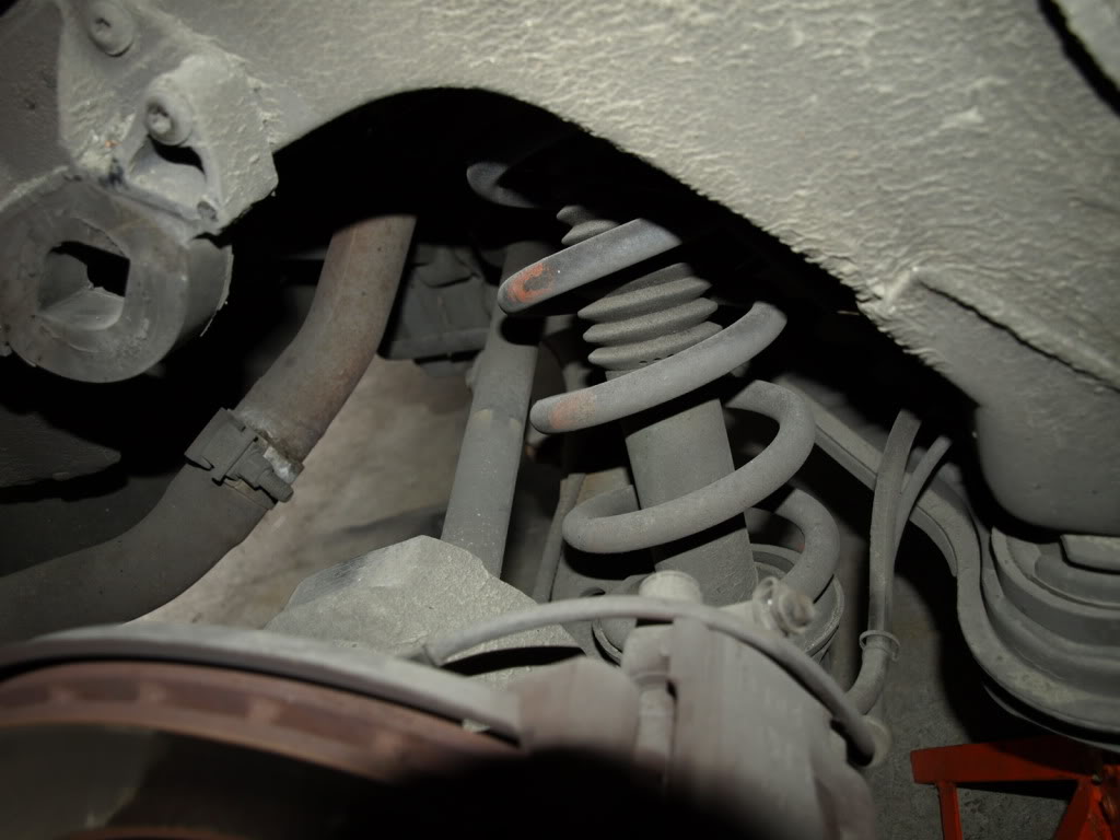

And as i took more time to look at the suspension of the x308, I realized that my idea for building a custom air suspension would be much more of a hassle than I wanted to deal with.
Solution... custom hydraulic suspension. I ordered a 1 pump 6 dump setup that will be using 1 battery. A minimalist approach since the suspension is being built as a way to drive extremely low as I like to and be able to navigate driveways and speedbumps with ease. I will be using 325 psi nitrogen accumulators to provide the suspension aspect to the hydraulic cylinders, essentially giving me the ride quality of a set of coilovers at lower heights and a near factory quality at higher heights.

The rear spring covers the entire length of the shock. I have no idea how a bag would be mounted back there... Replacing it with a cylinder will be much easier.
Suspension is en route to me at the moment.
