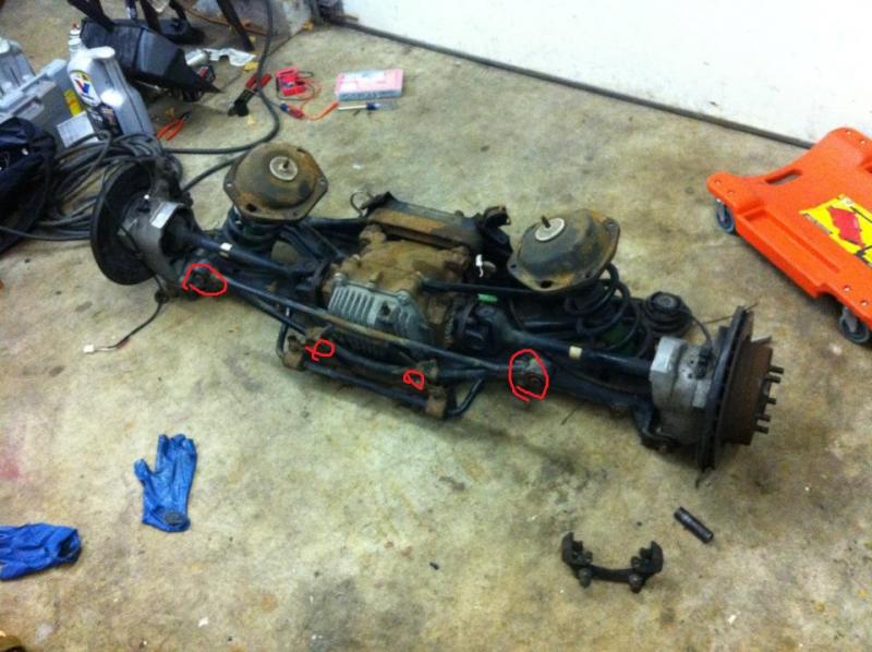

had the car to the mechanic today. Dropped it off in the
morning, he couldn't get to it 'till around 5:00,
but after he drove the car, he said it was obvious and
could be felt at just about any time.
We were both under there, and with a flat-headed long
screwdriver, we were able to move the diff around and hear
a toned-down version of my lovely slamming.
The only thing that was moving... the bolts.
After he tightened everything up, (the main culprits being
outlined in the attached pic), I drove the car off of the lift, and
immediately the drivetrain play, and loud noise were gone.
Easy fix! Despite him spending time on the car, and driving
it... he charged me a grand total of $0.
I offered to put an ad for him in the Jaguar Club of Tulsa
newsletter. I always recommend him to a friend anyway
though... So like Captain Picard says, I'll "Make it so."
this concludes my rear-end noise story.
Hopefully the car never ever ever needs a diff rebuild
ever.
(Too many dollars. I want a Jaguar racecar as
my 2nd car, not big jobs to do on my XJR)
Happy motoring! Time for a fun weekend.

what condition were the bushes like on the cross brace Ian? like the nice easy fix, and from the rear axle picture you can see just how many parts that could cause a knock, even with the A frame and prop missing...
Sean, you are quite right. Lots of little bits on
the rear end that can collide with something else
as the rear end is loaded up/ unloaded from the
engine's torque.
+1 Sean... I didn't need the rear end out, heima!
That would actually involve removing the very bolts
I went in to tighten. I just used that photo so it was
clear to see where those little culprits were.
The job was completed with the car way up on a rack.
Ian
