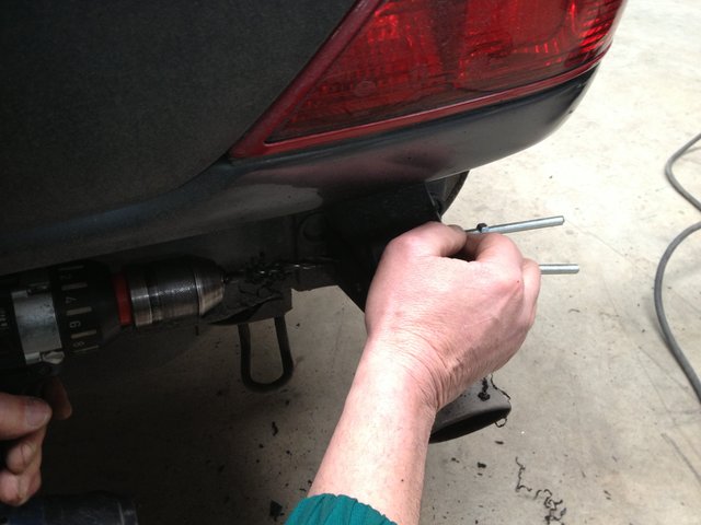

My homemade rear bumper repair
Two weeks ago the weather was terrible - it was raining all night long and then the temps dropped down to -5C so when I took off for work the roads were covered with ice... And just when I started to think about crashing and smashing the Jag a young driver with Citroen ZX hit me from behind... The result was broken rear bumper and some damage on the right rear fender.
So I left the car for painting at the local workshop and they did a great job on repairing the rear bumper specially when recovering the cracks on it... they used some kind of fiberglass to rebuild the broken parts. But they couldn't mount back the bumper... The combination of brass nut, steel bolt and aluminium mounting just make for corrosion and after a hit there is a very high chance that the brass nut will break free out of the moulded compartment as corrosion had really taken hold.
So I had a good looking bumper and repainted car... and I was searching for a mount it back. The problem is that the mounting bracket is kind of expensive part (pair of BEC25564) is around 160-200$ without the shipping plus I had to wait for a month for that delivery. Than I decided to make my own mounting brackets and here is a step by step what I did:

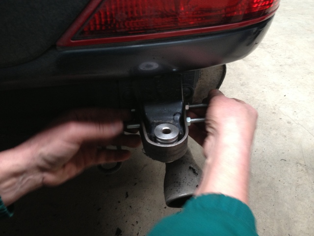

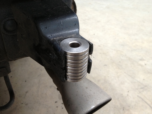

1. I created a new aluminum mount that would fit the car:

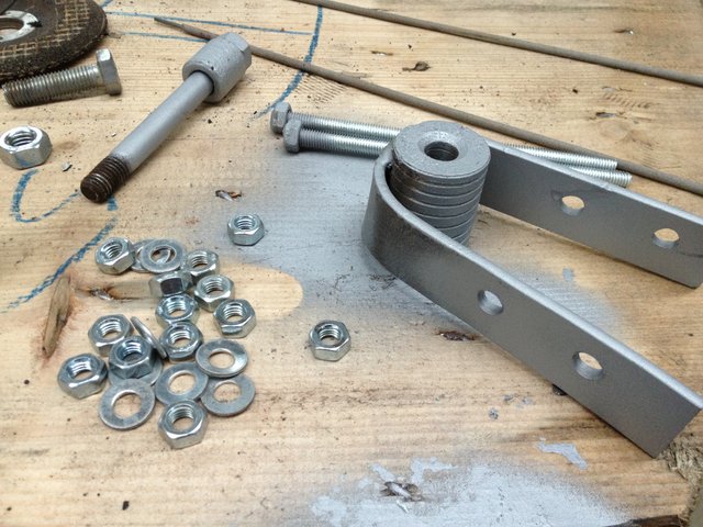

2. Then I took a metal plate and bend it around it:
3. Then I drill two wholes to fit it to the plastic part of the mount:

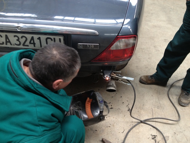

4. Then I did a little welding work on the metal plate and the new mount:
5. Then little painting to assure that no rust will destroy the new bumper mount

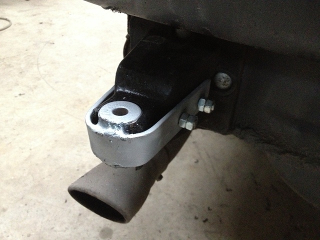

And it's done:
Total cost of the repair - 2$ for the aluminum block and a bottle of good whiskey for the friends that assisted me. Plus, believe me, this construction will last 10 time longer than the original

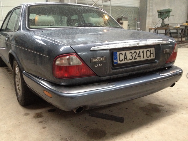

And here is the result:

Nice work, but you know I'm a picky so-and-so....it looks like it needs to come up a little to close the gap between body and bumper.
The problem with those bloody mounts is what you've found, a mixture of metals, add saline solution and they don't last long, mine had turned to an aluminium oxide dust. The other issue is they're 'impact absorbing' - once touched they're finished....
I snagged brand new front and rear mounts off ebay, so you might be lucky if your patient. People have to change them when they fit a tow bar. It's a nightmare to actually remove and replace them. I smothered mine with copper grease and the bolts too. I wonder if you can shim them with washers to close that gap?
Actually there is no gap
I took the photo minutes before we finished mounting the bumper with the steal bolts so it's standing free just laying on the brackets. After we finished the job the car is looking just like new
