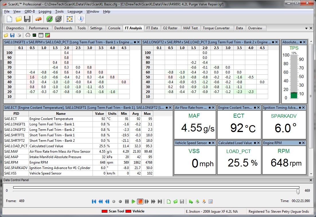

But normally, you should basically ignore the STFT. It only becomes important if it begins to TREND one way or the other. When it TRENDS positive, you will confirm that when the LTFT shifts positive to compensate. When that happens, the STFT stops TRENDING positive and TRENDS back to zero. Attached is a screen of a diagnostic session after a purge valve repair. This confirmed the repair was good. This is a 20 min. drive monitoring LTFT in the various RPM and Load Ranges. All load ranges are with a LTFT very near zero, that's perfect, I'm happy that my repair is confirmed. Now look at the table at the lower left. You can see the upper and lower extremes [min/ave/max] in the columns. You can see the LTFT stayed quite low. Now look at the STFT. That went from -18% to +21%! And this car is operating perfectly! This is my point, the STFT has value, but only limited value to us for diagnostics. The LTFT is what really tells the story.
