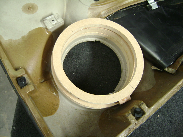

There are a few aftermarket sound processing options, like the RF 360.3, Audisson Bit1, MS-8, and a few others I can't remember off the top of my head. These will take your factory signal and 'clean it up' a bit, as well as letting you set the EQ and time alignment.
Spend your money on good front speakers, but also look into the install. A speaker is only as good as the space you put it in, and a set of small pods like I have, plus a sealed and deadened door will make a HUGE difference, plus it will be pretty simple for any audio store to do for you.
When it comes to amps, in general "a watt is a watt". You don't need to go overboard, but a lower end product from a great brand will still perform better than a top of the line unit from a cheap brand.

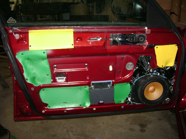

Here's what I mean about the speaker pod: click the pic for more details...

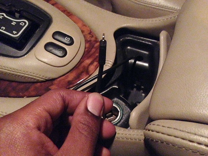

Center console armrest:

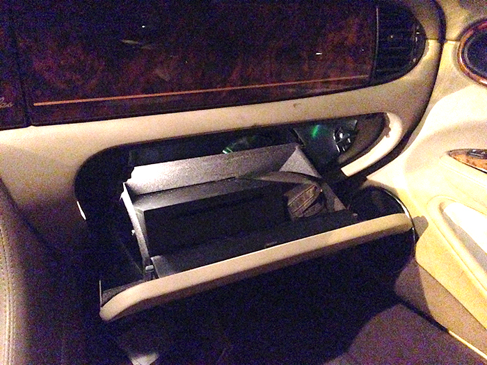

Glove compartment:
iPhone connection cable (better quality than Bluetooth although the bluetooth is VERY good and allows for handsfree calls):

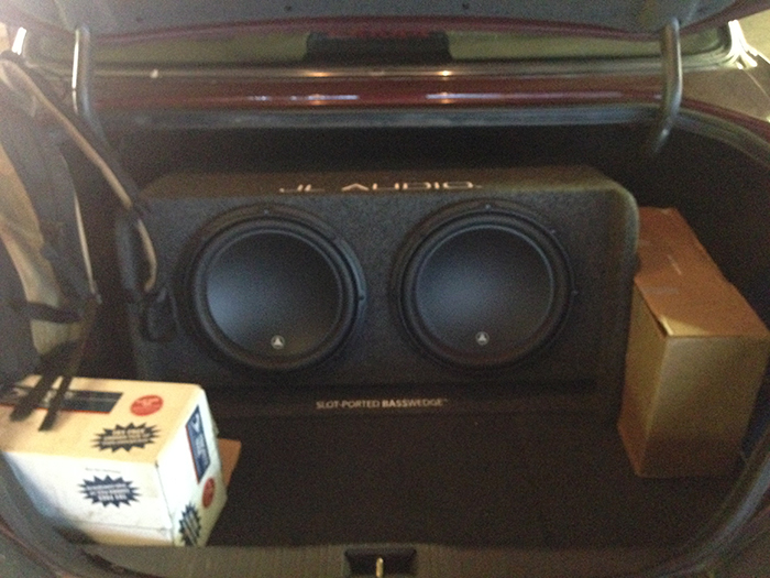

Trunk subs:
Had the trunk sound deadened, but based on the build of the teunk lids interior, this didn't change much of the outside sound. It did make for a more controlled sound inside though. Rattle wasn't too bad on the inside w/o, but now its pretty much flawless
My spare tire was a bad quality tire, I don't travel out of state with this car and I have AAA so I ditched the tire and used that area for the amps (too big a hassle to get you a good picture at the moment):

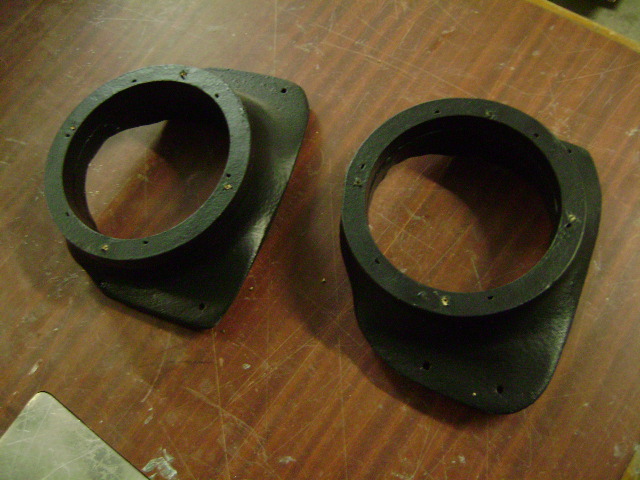

For those looking to add more bass, without retrofitting a sub, or wanting to put something aftermarket in the boot, I would again recommend looking at building pods for the front door speakers, so that they are mounted solidly onto the door, not the door card, and also have the door sealed and deadened. This will make a huge improvement, especially when coupled with new speakers.
Of course, if you want serious bass, then a dedicated sub is the best way to go, but if you're just looking for a fuller sound, and better clarity over the rest of the mid-range as well, then it will be totally worth the effort.
Show these pictures to any car audio shop and they should be able to replicate the results very easily.

Grandell, you're right about the door speaker pods--great midbase for sure if a dedicated smaller subwoofer isn't required.
