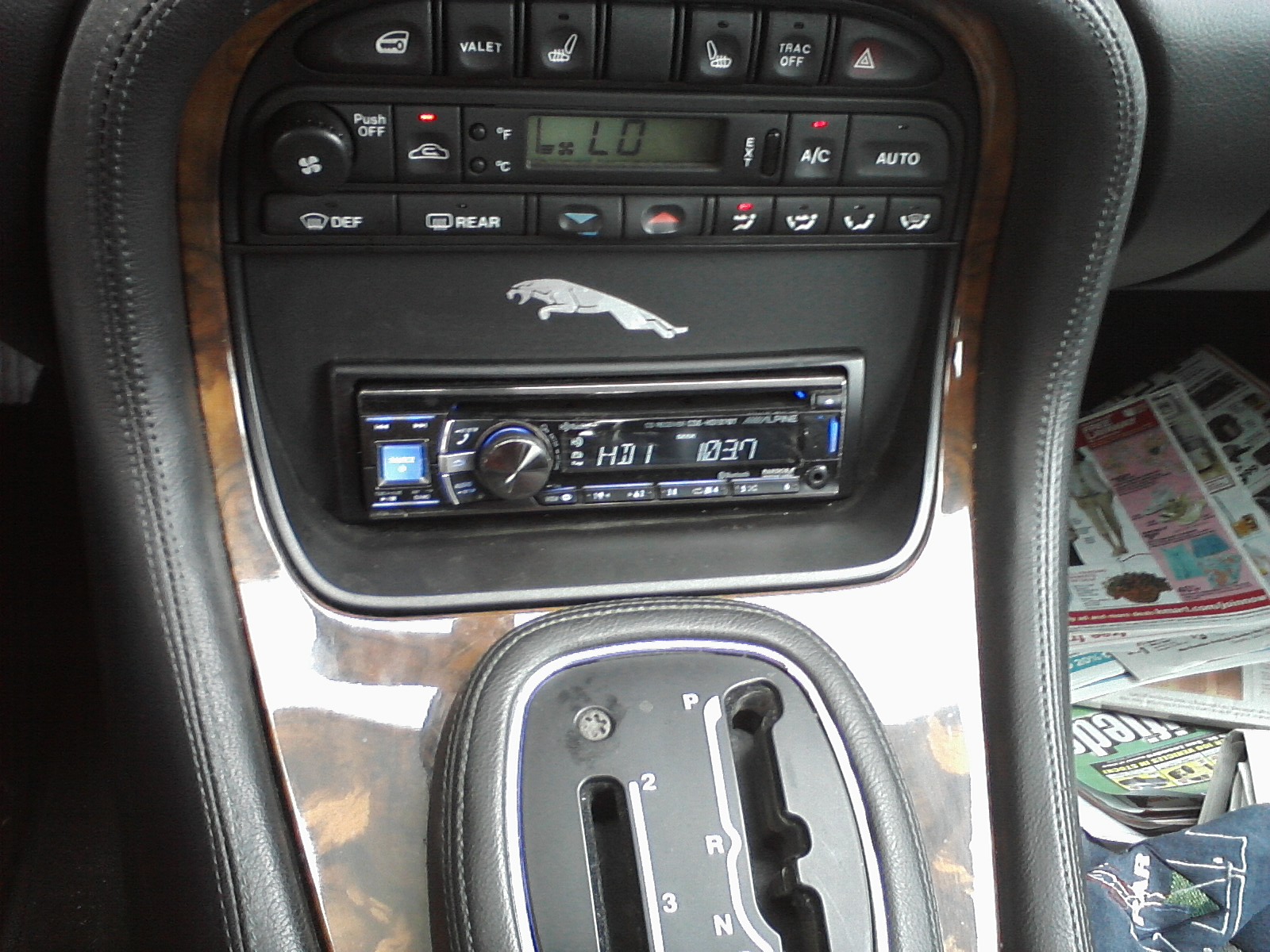

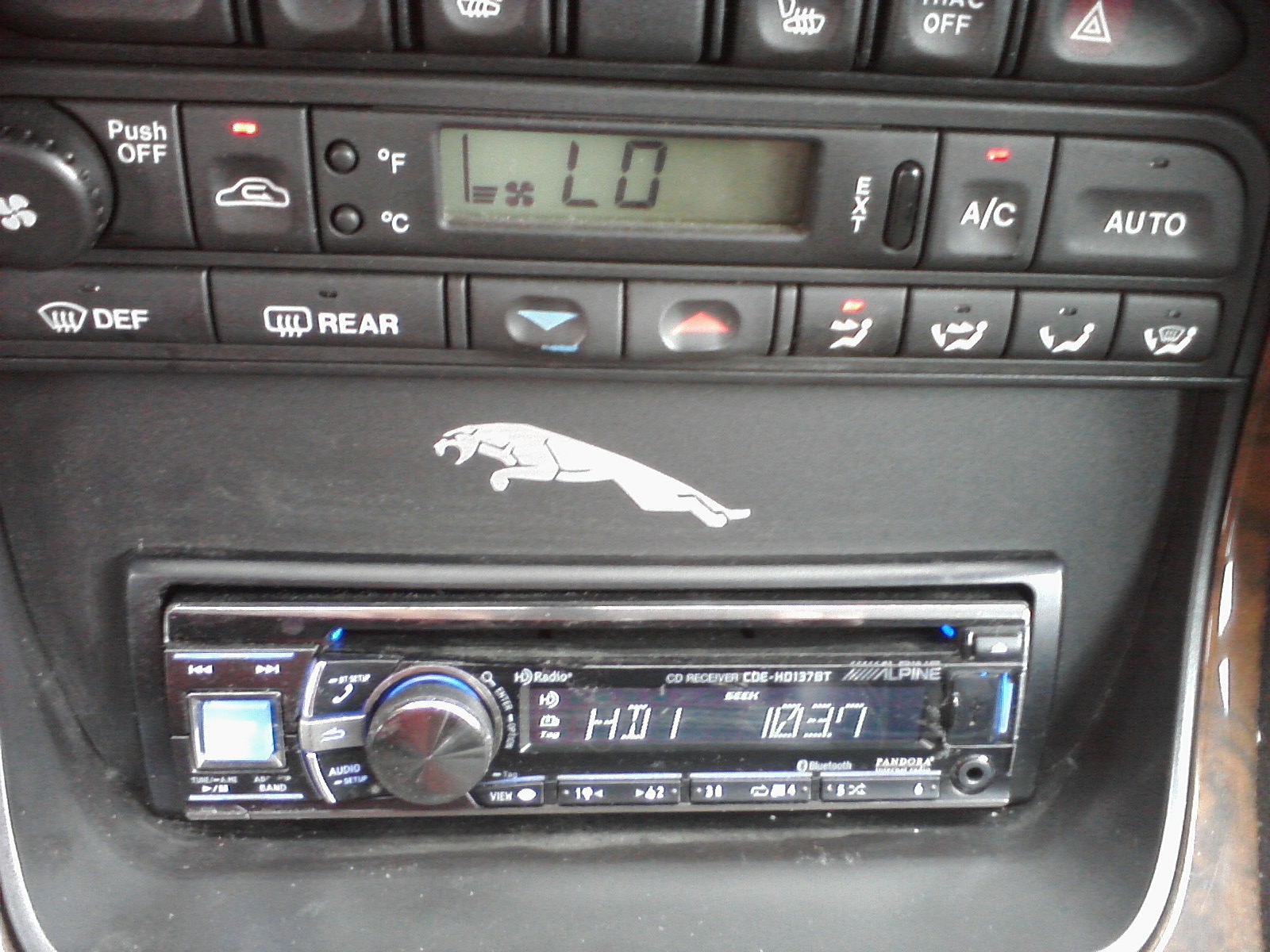

Old Mar 31, 2016 | 09:33 AM
  #57
CharlzO's Avatar
Joined: Feb 2015
Posts: 998
Likes: 262
From: Upstate NY
Originally Posted by ahmedalalousi
Hi all,
Great work .. well done.
I have searched high and low but could not find a double DIN bracket. Single DIN is readily available for the X308, but not a double DIN that I could find.
Any pointers?
Thanks in advance ..
short version, they don't make one. The structure of the dash behind the opening is such that there's not enough room to allow for the upper half of a double din to fit. There are exceptions, certain smaller screen models, with a custom faceplate and the right angle can clear, there are a few people who have done that. Otherwise, much chopping and work is required and it's not a pretty sight. There are some options, but it's not a plug-and-play like a single DIN is.
Old Apr 1, 2016 | 09:23 AM
  #58
ahmedalalousi's Avatar
Joined: Dec 2014
Posts: 76
Likes: 11
From: London
Thanks CharlzO
I'll take the centre console apart and see what could be done/modified. One option I had in mind was to make an entertainment system from scratch, with an 8" - 10" screen fitted instead of the OEM unite, and hosting the CPU to the system in the boot. Alternatively, an embedded board would easily fit in the space behind.
Will get my head round software - AppRadio is one option and runs on Adroid. That said, I had been hoping not to have to spend endless hours on this, hence the desire for a standard double-DIN unit.
Thanks again ..
