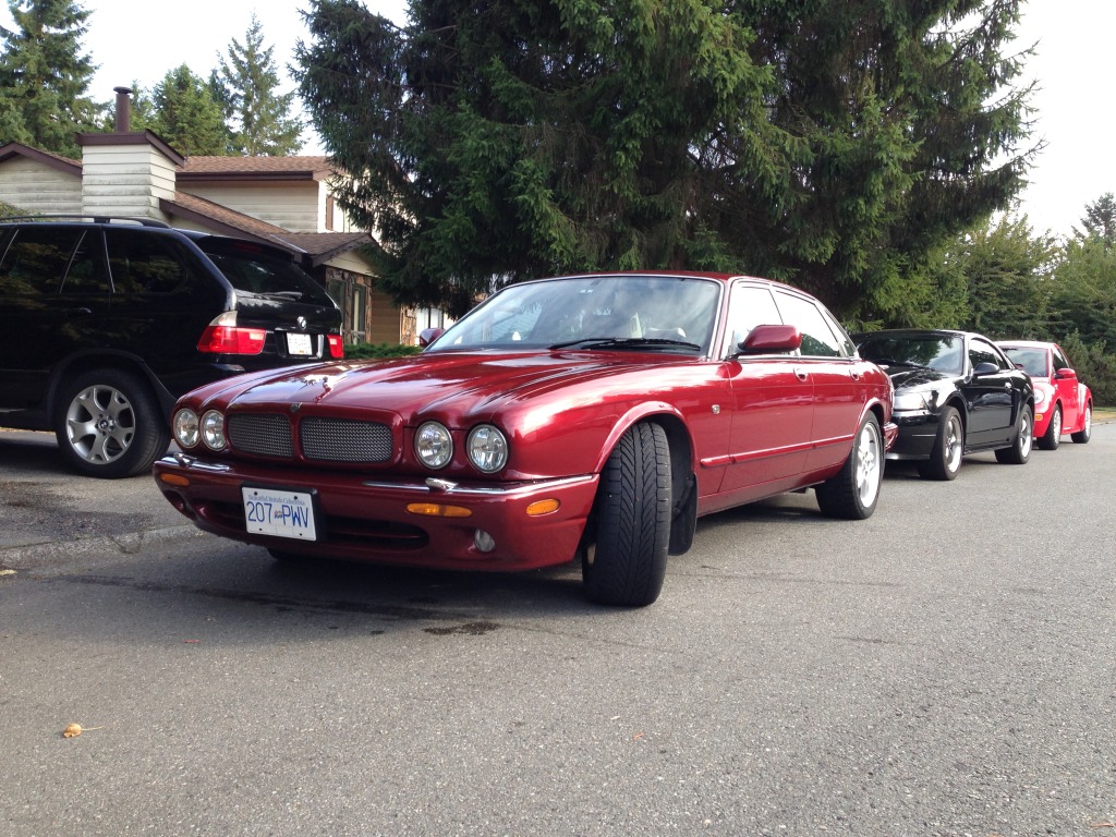

Well I'm happy now. She runs smoothly, and drives like a dream. I still have projects/questions, but that's the fun of owning these cars. The airbag light is on, perhaps because I had to remove the passenger airbag to do the carbon fibre mod.
I'd like to figure out a cheap/free way of resetting that. Then a couple dash lights are out, and I want to install bluetooth, program the garage remote, etc, etc.
Before and after:
[IMG][/IMG]
[IMG][/IMG]

While this project was underway, I sometimes wondered if it would be as quick as I hoped it would be. I am used to the XJ8, and I knew the XJR would be quicker, but how much?
I hoped I wouldn't be disappointed.
Well, no worries there. This thing is fast! At first it wouldn't rev past 5,000 in Sport mode, but after repairing the kickdown switch, and rigging the throttle to open fully, it's all good.
I'm very pleased with the results. 0-60 times.com says it should do 5.1 seconds, and my OBD says 5.7 seconds. Very smooth, very quiet, very fast.
