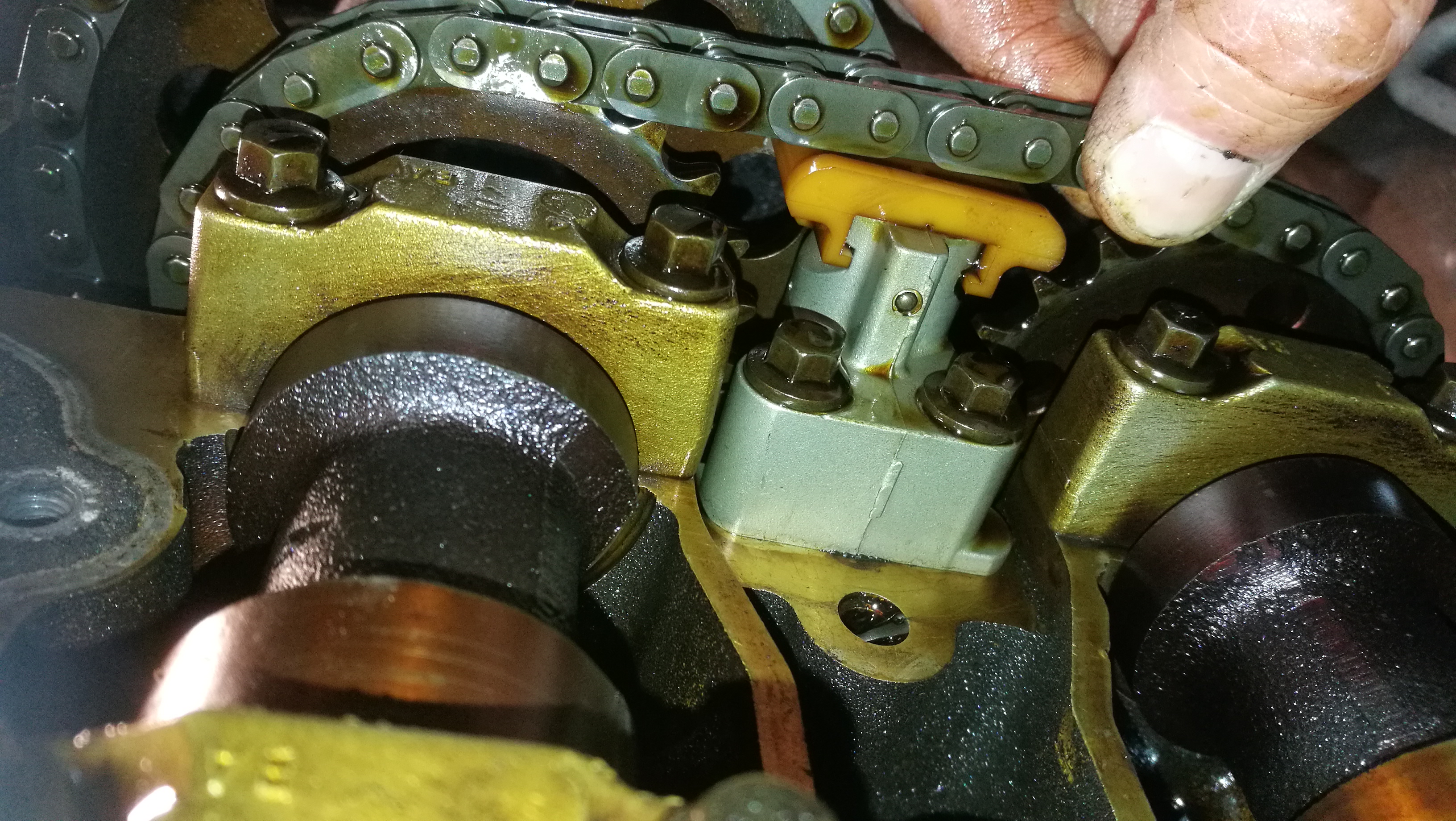

Is it ok that they loose the pressure when standing? My car has been in a garage four months. I opened cam covers and chains in left side are tight but on the right side secondary chain is not that tight anymore. I can lift it about 3mm on tensioner (see picture). Is it OK or is tensioner broken or oil pressure valve broken?

I believe that is normal. But it has been addressed in other threads.
The latest generation of these tensioners are spring loaded (no check valve) so they should always keep the chain under tension. I suggest you remove the tensioner, see what type it is and, if the older (check valve) type, replace it with the latest.
