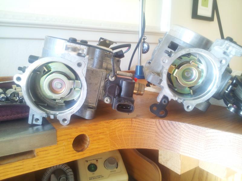

To update/close this thread, I looked at my two TBs side by side and the problem became obvious...
...maxbore re-assembled the bored out TB with the throttle assembly oriented 180 degrees off. He said ship it to him and he will fix it asap.
Problem solved, case closed
The Scrappy WaterDragon lives to tell the tale another day
Goopd job you spotted it mate....otherwise you wouild be driving yourself mental and everybody else ;o)=)
