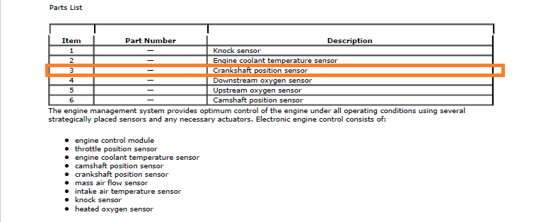

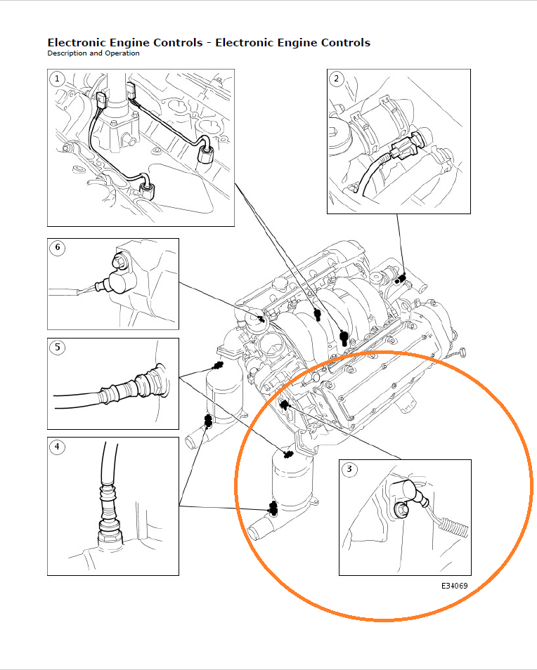

One thing you may want to check is your CPS (crank positioning sensor). If its dirty or the wire is damaged, it won't send a signal to the ECM and create a no start condition. Try cleaning it off and check the wire condition, possible road debris hitting the wires and check the connector.
