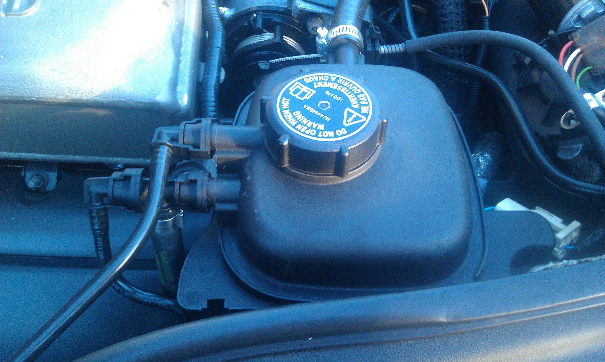

Are You SURE the two hoses at the top of the resevoir are not crossed? In other words, they should look crossed, the one to the engine side is supposed to go to the overflow, and the one on the fender side is supposed to go to the radiator.
I thougth I sw that addressed previously, but I don't see It in the thread!

Yes, positive the hoses are installed correctly. In fact I just now removed the upper hose (to the overflow) and did a vacuum/pressure test (ie I sucked and blew on it) to verify it's connected to the overflow. I got bubbles and a mouthful of Dexcool. I replaced the o-rings as good measure, but I think those connections are solid.
That said, today was drip-free, so I think it's fair to say the previous dripping was a result of me overfilling the system. Sadly, however, the level in the reservoir is down slightly from this morning following about 30 miles of driving. Not good, but I am also not surprised... clearly there is some explanation for the original Low Coolant warning. I had no choice but to start dismantling things. That lead to some discoveries!
