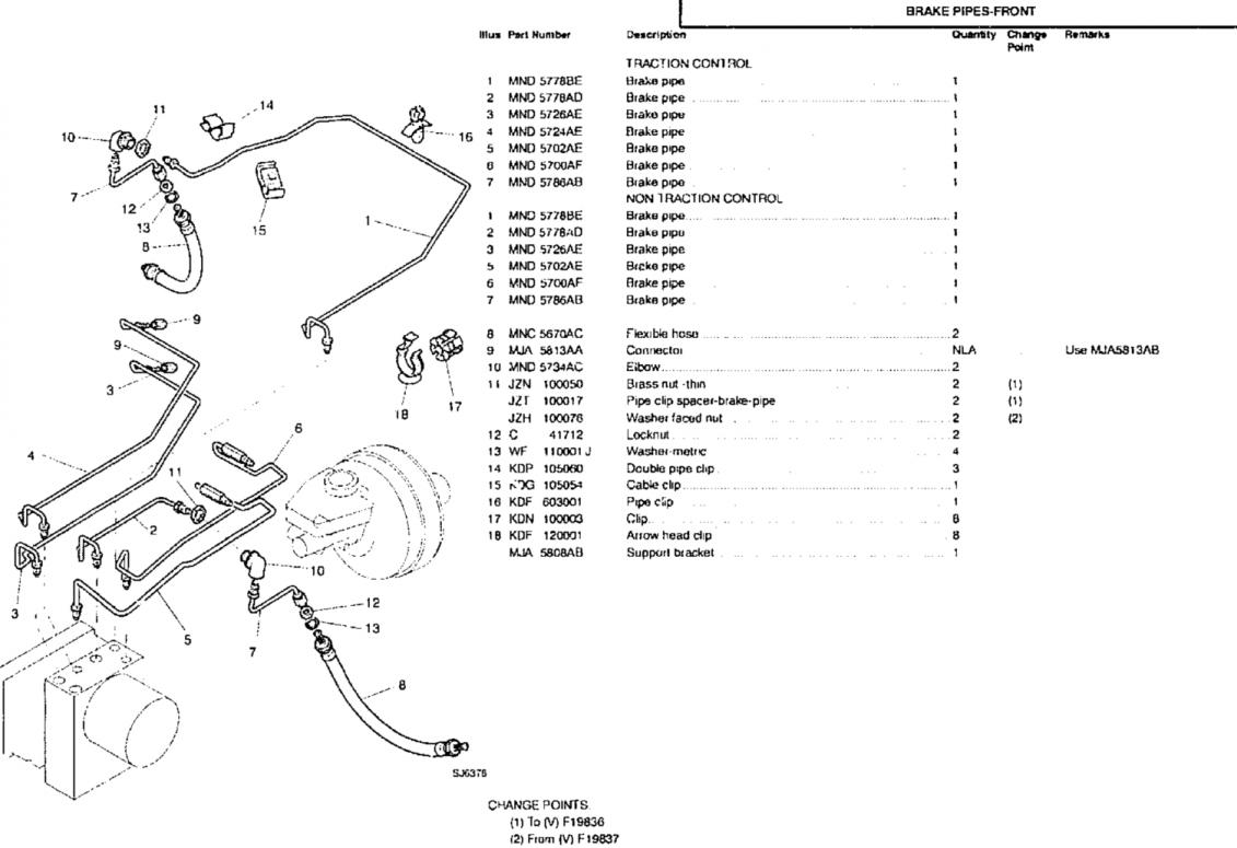

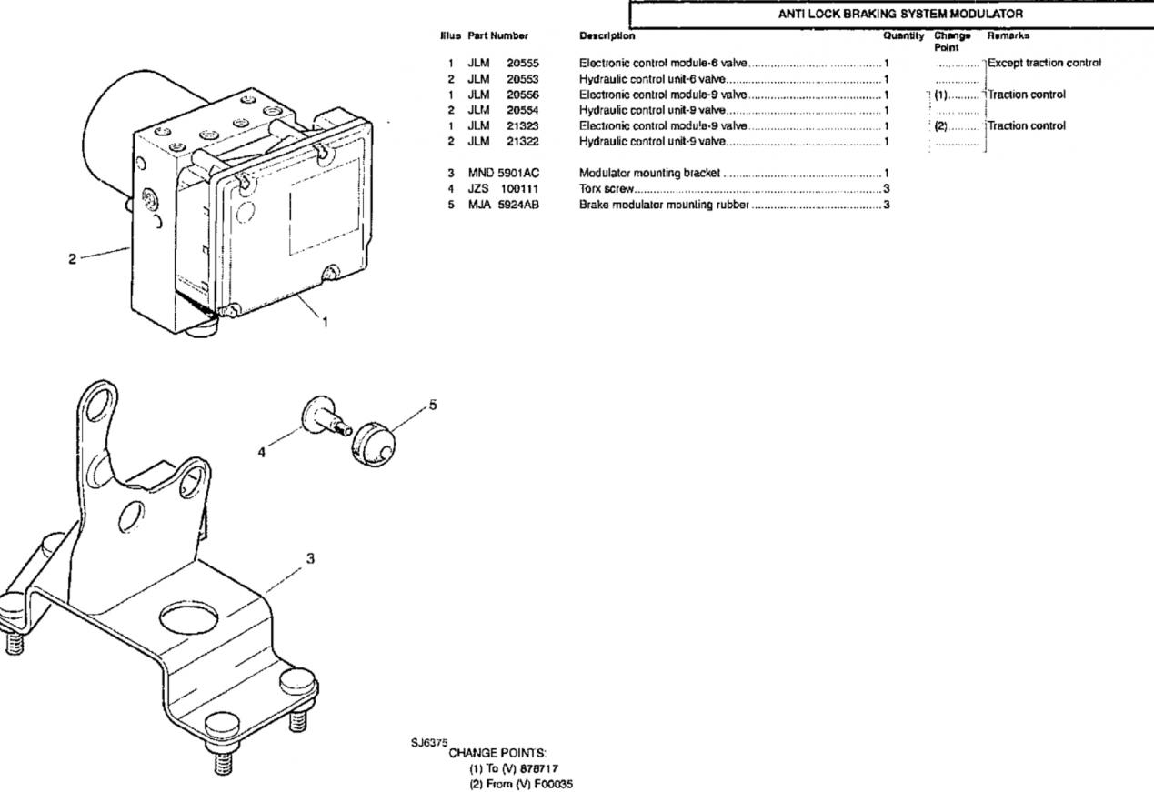

This might be a nice addition
Attached Thumbnails Newbie Question - related to the dreaded ABS/Traction light-abs1.jpg   Newbie Question - related to the dreaded ABS/Traction light-abs2.jpg
