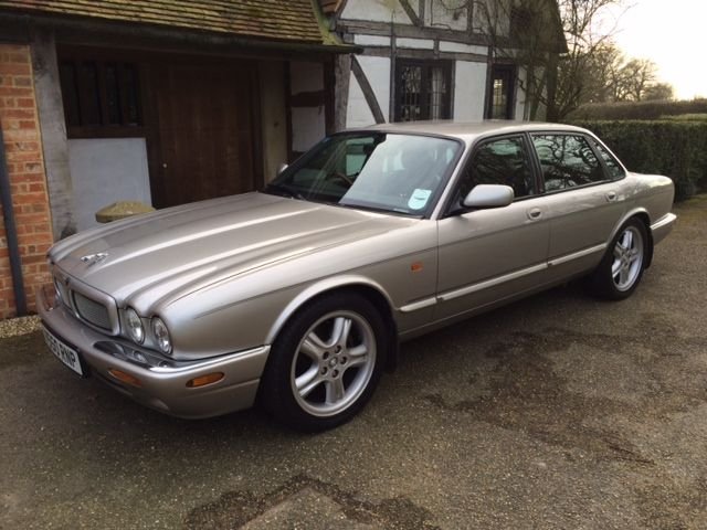

Vanquishspirit's Avatar
Posts: 7
From: Kent
I am trying to get the hang of this forums engineering but here is a photo of the offending Lady. Back in my good books.

badger2196's Avatar
Joined: Jun 2014
Posts: 196
Likes: 31
From: Larkspur, CO
Very nice ride, and doesn't it feel good to have all of those weird issues resolved by something as simple as a new battery!!

andrew lowe's Avatar
Posts: 1,996
Likes: 415
From: croydon uk
She does look nice and clean.
Just hope she behaves herself for a little while.
As the lid of my toolbox says, " If its got t*ts or wheels, at some point it WILL give you grief "
