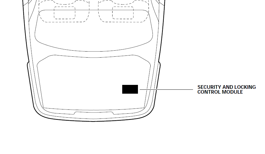

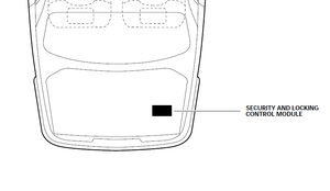

The SCLM security module is in the boot underneath the fuse box. Your SCLM is probably working properly or you would be unable to start the vehicle. When you lock the vehicle with the key the security is engaged. If you doubt it is working just roll down the drivers window, lock the car with the key and then reach in and open the door from the inside latch. Be ready to insert the key in the ignition to shut off the system and quiet the racket.

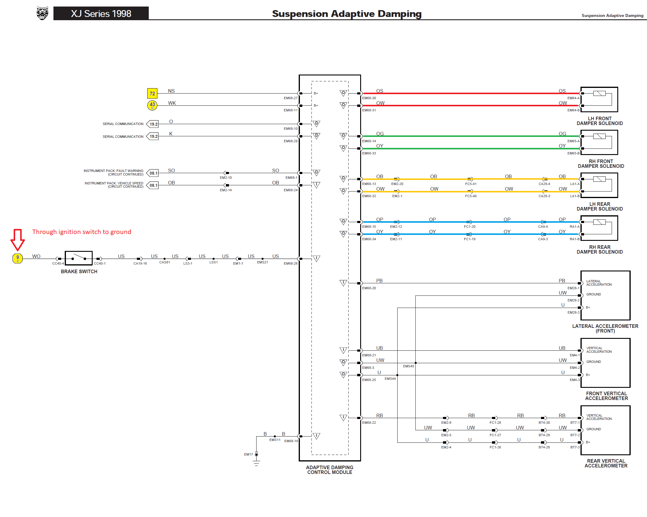

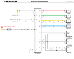

For a 1999 XJR do you have the active suspension system ? You will have wires coming out of the top of the shock towers which sometime rub and short out .
If it gets to it :
http://www.bagpipingandy.com/installation.html

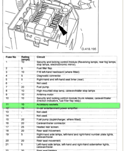

Look at fuses ,
fuse # 1 / 20 amp Engine Management Fuse Box
fuse # 5 / 10 amp Engine Compartment Fuse Box
The solenoid wire pairs should read the same resistance and check wires for a bad car frame ground

Look at fuses ,

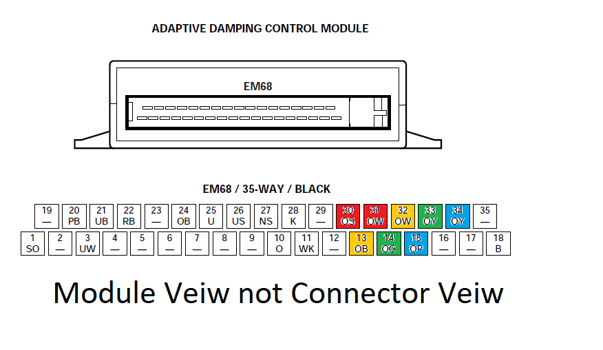

I did find the right connections allready but didn’t have the time to measure through the solenoid wiring yet.
One question? When you say “bad ground” in this case, where would I look first if you where guessing?

Bad use of words on my part . You do not want to see a shorting wire that is grounding the wires to the frame or the car . So for all 8 wires that go the the solenoids ensure that you do not have a low resistance to to the frame . You would have to find a good grounding test point like one of the built in ground studs . Have someone massage or manipulate the wires out of the top of the shock tower ( to try to make it fail as if there is a bad wire it may be intermittent and not show the failure with still or static wires ) .
