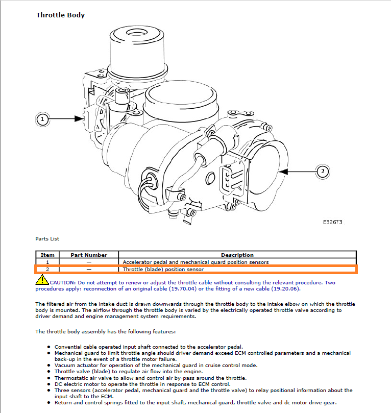

Just what is says, check and clean the CPS (crank positioning sensor) and connection at TPS (throttle positioning sensor).
This is from the X308 Workshop Manual, which cannot be uploaded here because its too large. But can be found where there's a Dropbox link to do so.

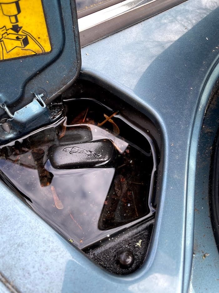

So this one is solved and is not what I expected, I decided to drain some fuel into a container to check fuel flow, this is what I found:
(The crud is just because I used a dirty container, it's the milkiness)
Last time I checked petrol was clear! Suspicion was water in the fuel, started to drain it into a Jerry can so I could put some fresh fuel in, whilst I was waiting I took at look at the cap:
That would do it! Drain hole blocked + sitting for a couple of weeks caused contaminated fuel, after draining and putting some fresh fuel in, it started up. Ran a bit rough for a while but not is pretty much fine!
