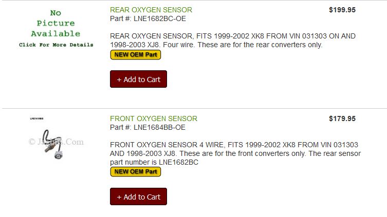

I seem to have been posting in the wrong forum. I have been chasing error codes in my xj8 for a week. I am now down to an O2 failure. Switching the O2 connector plugs at the firewall moves the error to the other bank. My problem is finding a store that can get me one. It also seems that they will cost $300. I have read the Jag " S " O2 sensor will work but sometimes in the pics it shows a round plug and sometimes a grey square plug. I need a square plug. Can anyone help me on this?

You might want to contact Jagbits a Forum sponsor as you can see from the attachment they are well below the $300.00.

If you are talking about the upstream (upper) oxygen sensors then the following worked great in my X308.
Amazon Amazon
Mine is an XJR, but I think they use the same oxygen sensor.
