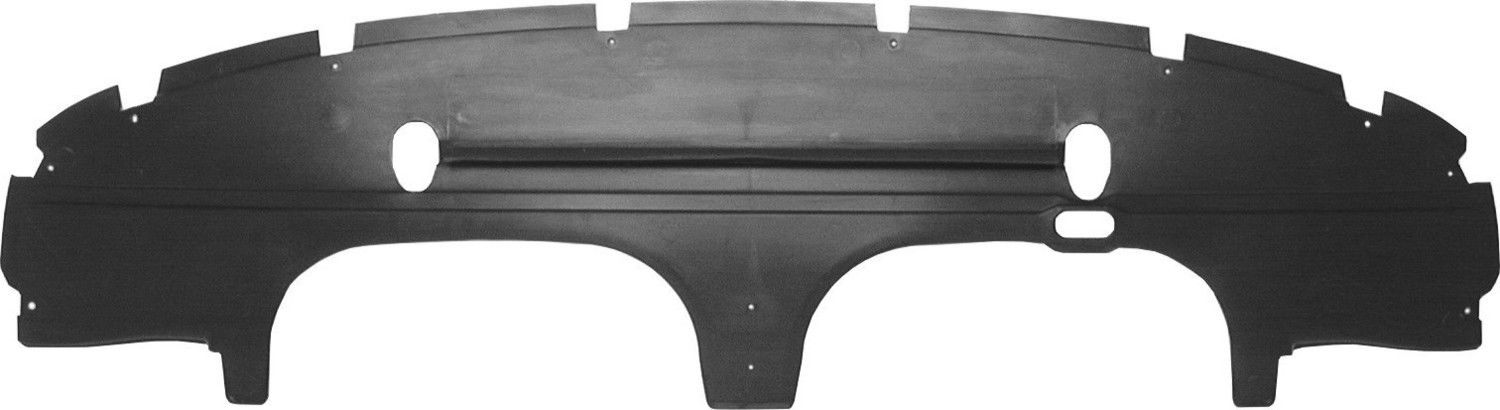

Hi guys,
I just noticed that my beastie does not have the under carriage cover? that item that is suppose to help keep the under side of the engine compartment (cleaner?) covered, don't know where or when it got lost. So my question is which one of these is the correct one for a 2000 XJR?
Attached Thumbnails which one of these is correct?-s-l1.jpg   which one of these is correct?-s-l400.jpg

The top one is what the X308's have. Regarding the one below I've never seen before. Unless that's for a euro spec car, I don't think they have a belly pan. Where did you get that picture at and was it specified for an X308 car?

Thank you for the response, here is the link to the larger belly pan it does say "URO" but I just thought it was a brand name, as "Euro" is how most people refer to Europe.
URO BEC19939 Engine Splash Shield | eBay

The shorter one is what's on my 99 XJR but thanks for the ebay link. I found an engine shield for my e39 beemer at a reasonable price, from the dealer these are ridiculous! I was trying to fix the one that came with my car by glassing over it but it's a type of plastic that doesn't like to stay attached to epoxies so I was getting frustrated. For this price it's not even worth looking for my mixing cups & rubber gloves!

The small longer one is what I've seen on mine, after I ripped it off on a road dip lol.

BEC19939 is the right part number, the picture on right is generic and wrong (note the "image may vary from the actual product" at bottom).
