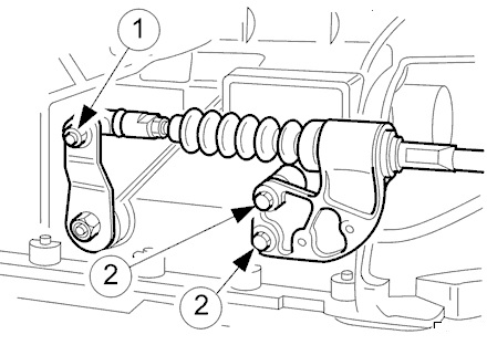

It's not difficult but depends on whether you have the facilities to raise the vehicle sufficiently to work on the transmission connection from underneath.
The cable route is from Transmission Selector to LH side of the Transmission:
Connection at the Transmission is:
