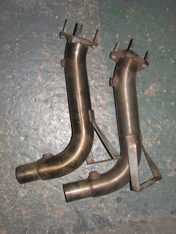

I have these on my XJR at the moment....... No CEL not a massive sound change, I cant even tell you if they offer more power either, I fitted them as the cats had rusted badly and I took them off my track XK as a temp fix...
