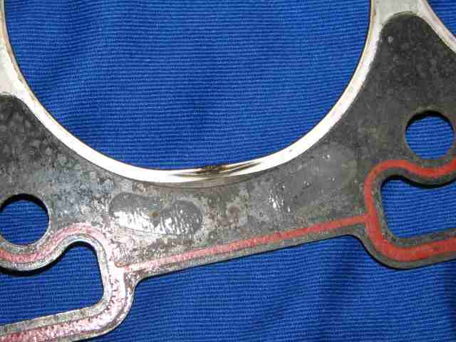

Sure sounds like a blown head gasket. If you drive it reasonably, I don't see what damage will occur on a SHORT trip to the shop. And... get the shop to save the blown gasket so we can compare pictures.
How much did it cost to fix?
