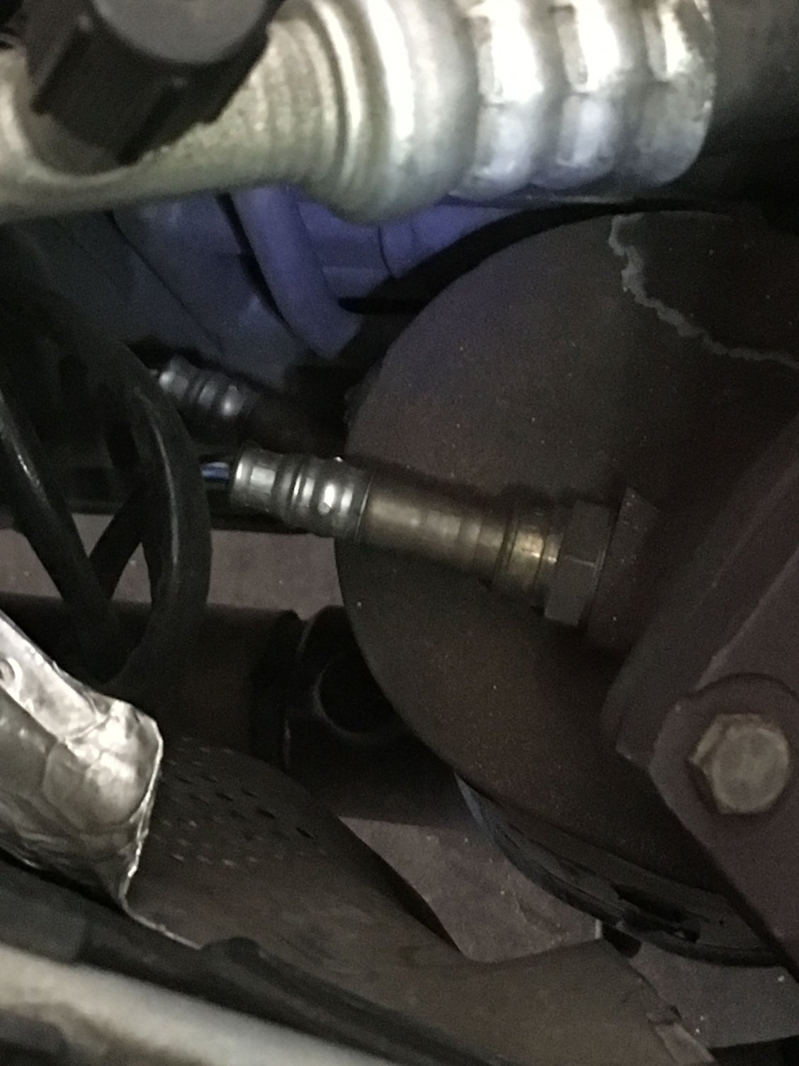

Would really appreciate some feedback please. Showing a code of P0174, an upstream sensor (likely) I’ve been told. Looking down the engine on the passenger side, I see two sensors one above the other. I followed the wire leading from the lower sensor and it attached to a black plug. I then followed the wire leading from the upper sensor and it attached to a gray plug. I really hope the sensor that needs to be replaced is the upper as it is so easily within reach. Thank you for your feedback.

Are there other DTCs besides P0714 stored in the system?
Before replacing the oxygen sensor(s), check for vacuum leaks on Bank 2. Has any work been recently done to the inlet manifold or that side of the engine?

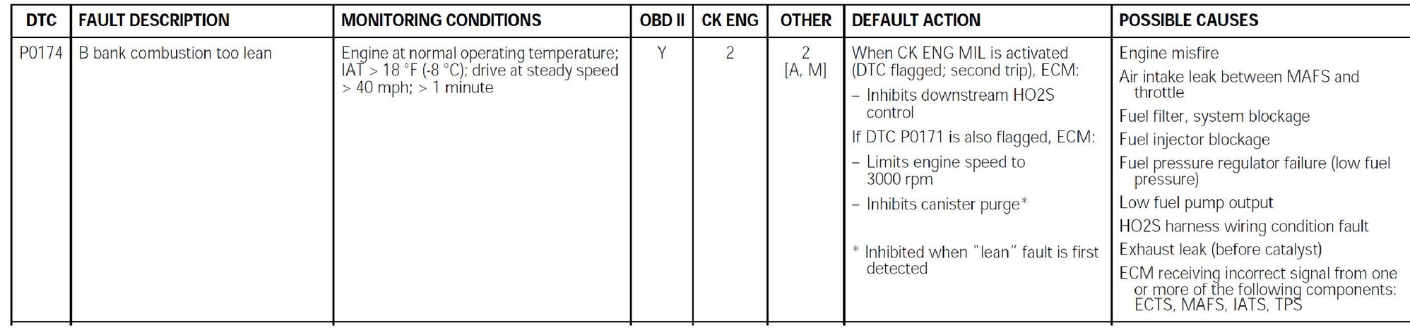

P0174 does not refer to upstream (front) O2 sensor.

When I had a P0174 error code (System too lean Bank Two) it turned out to be an early warning that my fuel pump was failing.
Several weeks later, it was proved to be correct!
