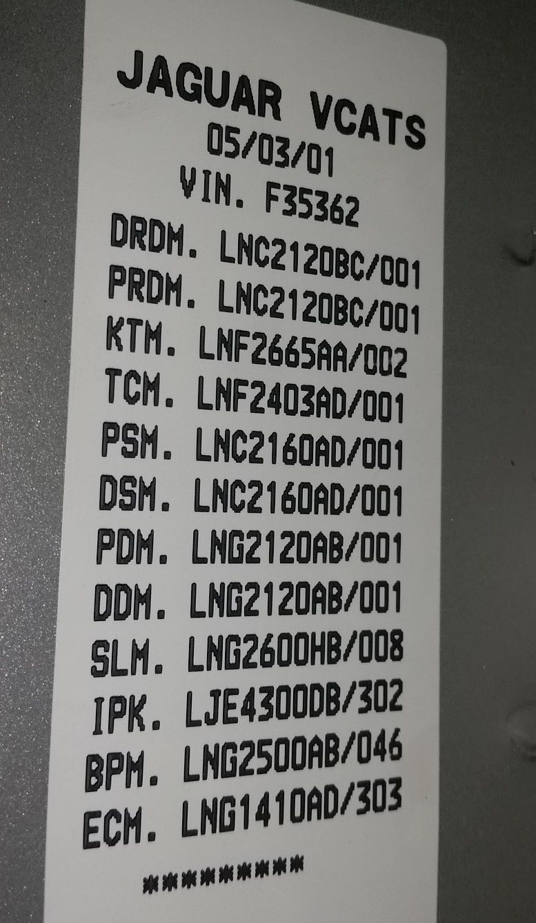

The TCM like any of the modules in the system shouldbe replaced following the VCATS number. In the boot/trunk there should be a large label in the spare tire space wall. It lists the module numbers. You need to match the number used for your vehicle. The one exception is that the number ends in a letter. So if your last character is say C then you can use a module with the same number ending in c, d, e, etc. You can not go backward a, b, for instance.
The letter character denotes the firmware version.

If you get the correct one, as per the guidance in the above post - it should only take a 'hard reset' and deleting the legacy fault code.
I've got one in the shed that might do, dig out your VCATS and post the part number, someone else might have one nearer to you.
VCATS...

Hi
Had my girlfriend look for the VCATS to no avail, may have to wait til I get home in 2 weeks but was hoping to have parts waiting for me when I get home.
The jag dealer said the newest part number should be LJD2401AC00D (NLS PART), my local Jag repair shop has a used LJD2401AB that he wanted $200.00 for. I mentioned that the same ones can be had off ebay for $100.00 delivered apparently I insulted him..
So I can find these on ebay LJD2401AB and LJD2401AC are they interchangeable for my Vanden Plas?
