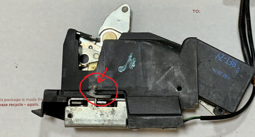

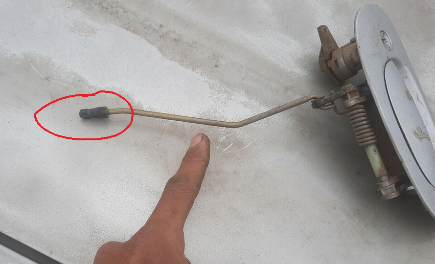

It looks like the door handle itself is functional. The operating rod is moving, so the problem has to be further in the mechanism.
Check if that operating rod is actually attached to the door lock actuator. If it's not, that's your problem.
If it is connected, the rod may be out of adjustment. Try disconnecting the rod and moving the actuator manually. If that does the trick, adjust the rod to be longer.
If that does not open the door, you're probably looking at a broken door lock actuator. That being said, I'm far from an expert so take my words with a grain of salt.
Check to make sure this piece is connected to the actuator.
The rod should be connected to the trailer hitch-looking piece on the actuator here.
I believe you can rotate this piece to adjust rod length if necessary.
Hope this helps, update us if you have any more questions and if you get it fixed!
