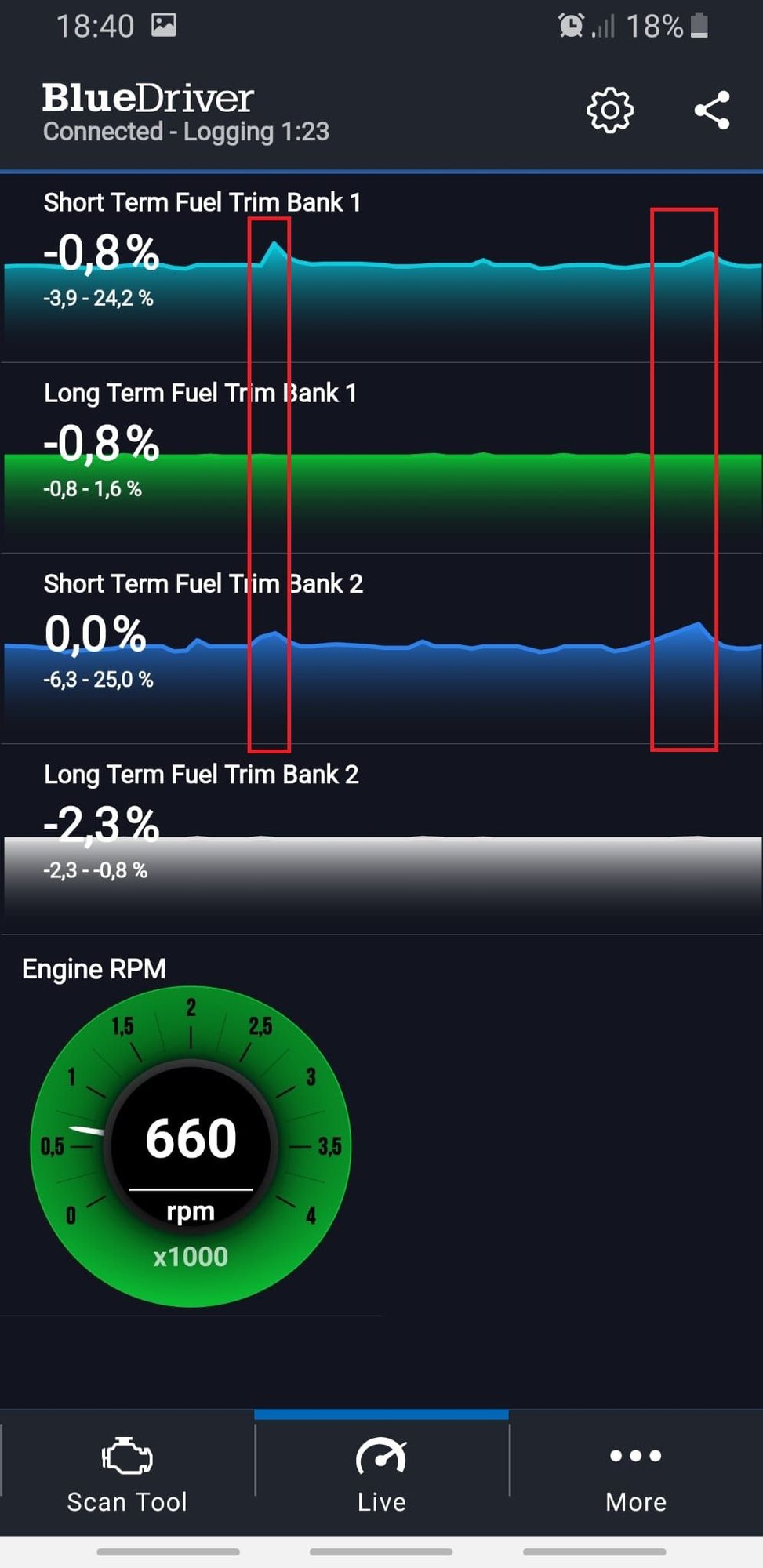

I have no experience with fuel trim data. I have recorded my fuel trim data on my way back home from work where I drove 20 minutes mainly on country roads and a little bit of city driving. I think 30-45 mph (40-60 km/h) on average.
Please see the attachment.

If you can take the same photo while the pinging is occurring, that would be ideal. Don’t try it at full throttle and try not to let it ping any more than you need to so you can get a good picture. As an example, hold the accelerator between 50-75%. If it’s less than that amount, then that’s fine too.

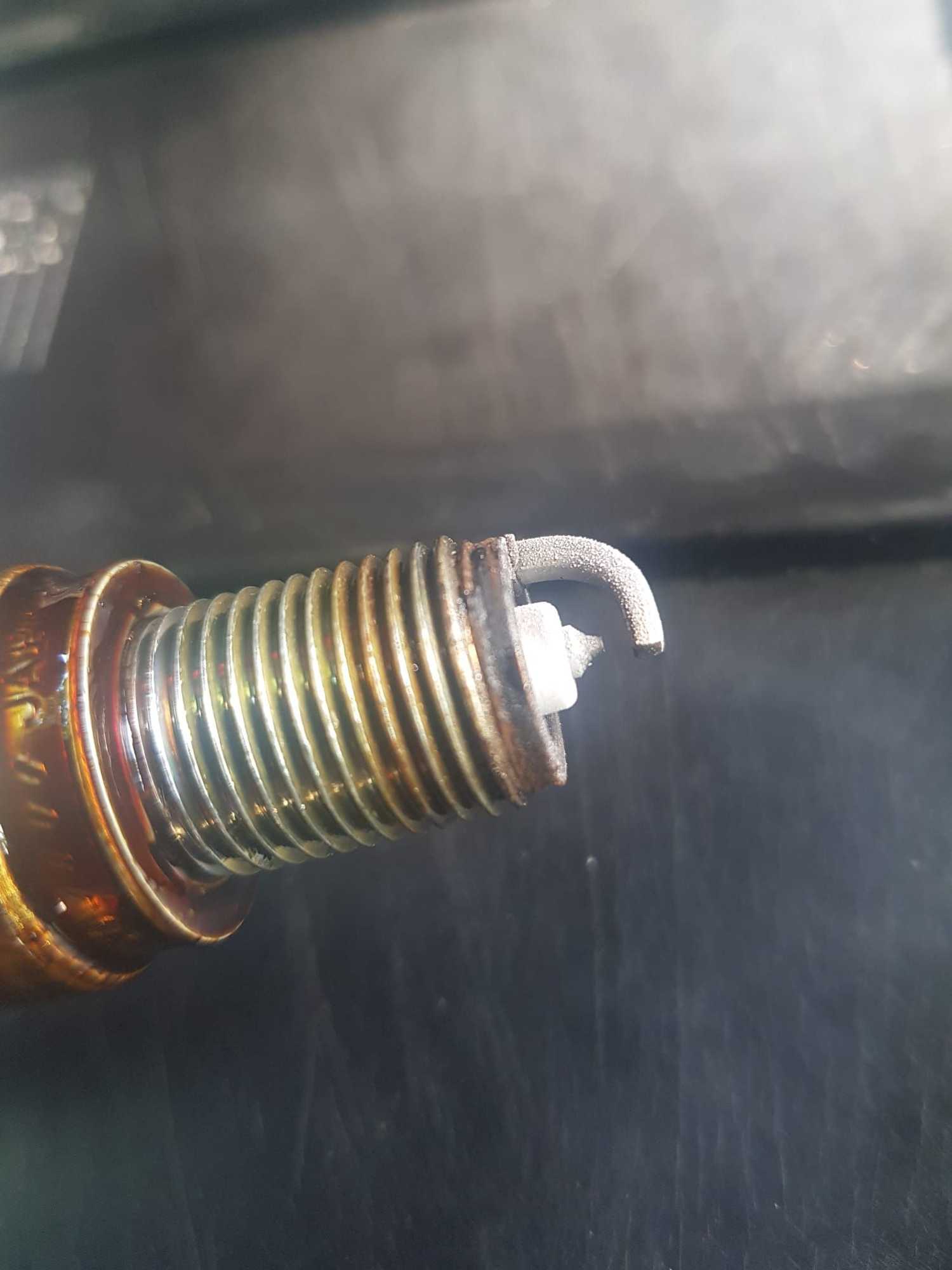

This morning I replaced some ignition coils and checked the spark plugs with the battery disconnected so that the computer was also reset before my long trip today (about 160 miles). I was very careful and didn't overtake quickly or accelerate hard. When I got home, I revved the engine a few times with the OBD2 scanner and live data while standing still in the parking lot (no higher than 2500rpm).
7 out of 10 times the rattle was noticable. It's guaranteed to happen when the engine is all the way back to normal idle speed and you're revving up.
With the help of red squares I indicated when the rattle was audible and also a kind of backfire shortly after giving the throttle. (a short series of dull thumps heard only with the windows open). The P0420 and P0430 codes are also back after this trip.
The oil looks good and the engine didn't get too hot. Are the characteristics something obvious or should I, as you mentioned as an example, see what the car does when you keep it at 50% throttle?
Revs with rattle/pinging/backfire
Spoiler
Originally Posted by JagV8
Could well be failing coils or a air leaks.
Look at the MANY threads for what to measure & when.
I took out the plugs and coils to inspect them. As I had 3 more spare coils laying around, I replaced 2 coils on the left bank and one on the right bank. It didn't make a difference. It's running fine on all 8 cylinders. The spark plugs are looking fine(ish?). They about one year old. Please see my attachments for how the spark plugs looked.
Spoiler
Spark plug
Spoiler
Spark plug

The plugs look whiteish but, that could be one of those things where I’d have to see them in person to be able to see if they’re more greyish brown vs whiteish grey. Having the same 420/430 codes come back could also mean your cats could be blocked from them breaking apart and laying sideways and blocking the flow of exhaust and can cause that detonation you have. If I were you, I’d take the cats off and inspect them. Another thing you could do instead is remove the oxygen sensors and use a bore scope. Either way you choose, make sure the exhaust is completely ambient temperature and spray the fasteners (or 02 sensors if you go this route) with a really good penetrating fluid. Here in the states I use PB Blaster. I know there’s others out there but WD-40 is not a penetrating fluid. After you soak them down, let it sit for at least an hour and use hand tools only.

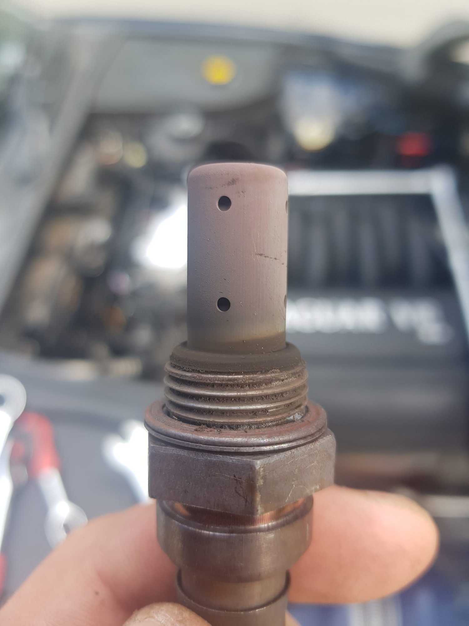

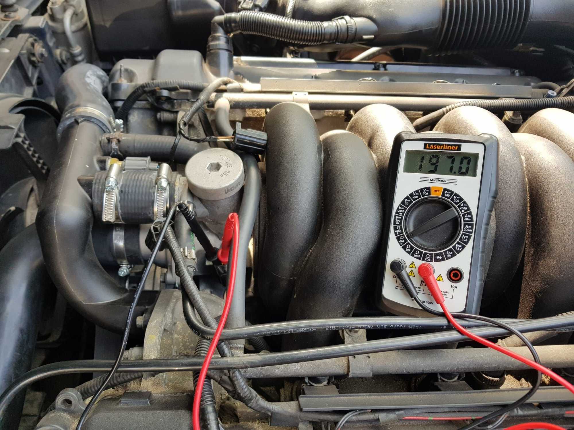

I did some testing and I think I'm onto something. The knock sensors are good, they measure 198k (right) and 197k (left) ohms. These should be about 200k ohms if I'm correct.
Spoiler
The top O2 sensor on the passenger side (EU) looks perfect. No weird deposits on the sensor and it was very clean actually. Unfortunately I forgot to borrow a boroscope so I couldn't see inside the catalytic converter, sorry.
Spoiler

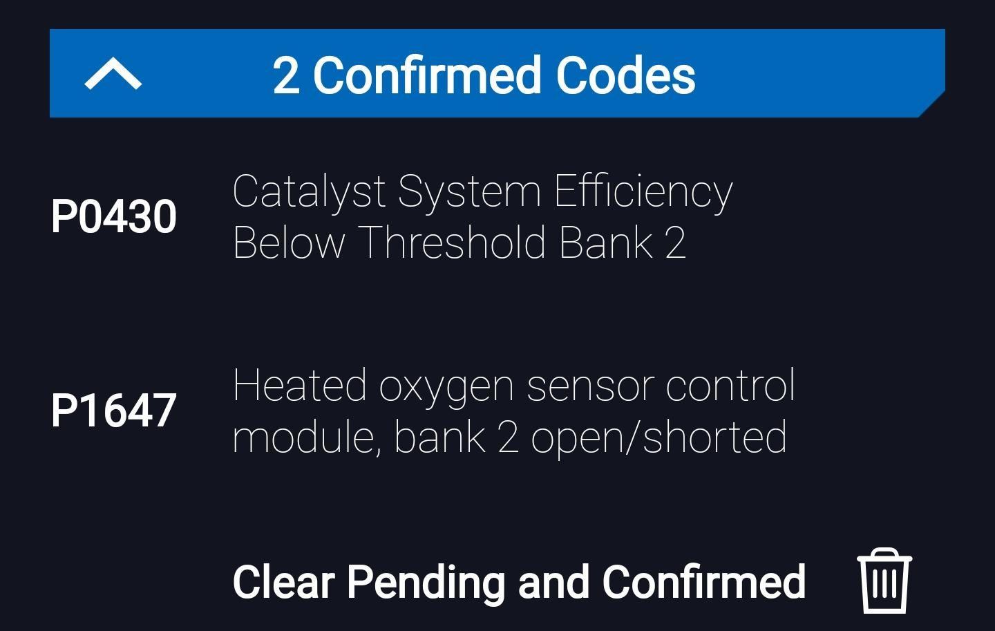

Small progress!
No vacuum leaks around the throttle body.
The code for the driver side has returned (P0430) has returned, but the other side (which I had replaced) has not come back!
I also now suddenly have P1647 (which comes right back after every reset).
Spoiler
Looks like I'm going to replace the driver's side catalytic converter (under the coolant reservoir) as well. I'll check the top O2 sensor and see if it's really faulty, or just a loose connection/damaged wire.
