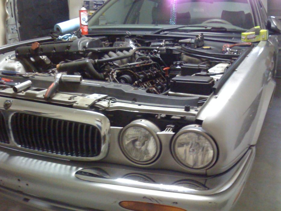

Your not alone...ole girl is currently in the O.R. herself for a bit of forward engine surgery.
