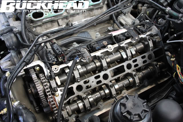

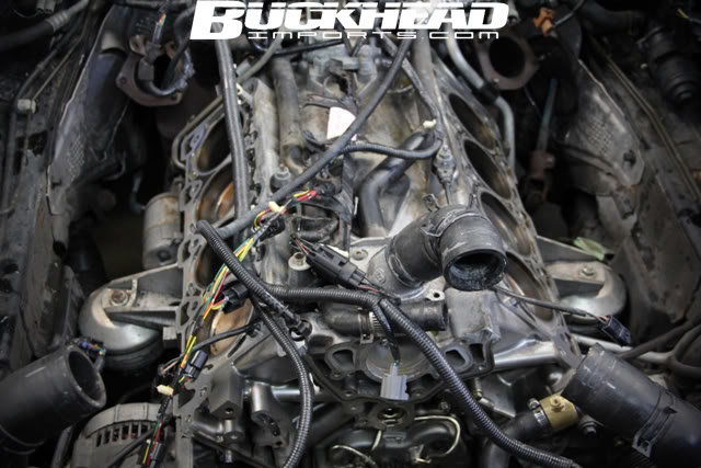

Hey guys just wanted to drop in and give an update on Thundercats XJR and what we plan to bring to the Jaguar community. With this project we have had the opportunity to create and bring quality dyno proven products through extensive Research and Development.
A little background about B.I.P. we have been in business for over 20yrs we have two facilities and have a combined 100 + years of automotive knowledge and we strive to be the best at what we do. Our Buckhead Location has been around for 20 years and has serviced MB, BMW and Jaguar vehicles for the Atlanta community. Our Smyrna location is our performance shop it’s fairly new but the new part is only for the building. We have factory scan machines, state of the art data logging equipment, AWD dyno dynamics for tuning and state of the art tuning equipment.
Enough of the boring stuff on to the build,
2003 XJR, car came in the mods already and laid down some very good numbers to start with, but wasn’t enough for the customer. Mr. Carnevale decided to call us for his build and we are very glad he did.
Dyno chart with current mods:
Supercharger Pulley, lower pulley, tune, ported supercharger, Magnaflow exhaust and water/meth injection.
These are the products we plan to have ready to go within the next few months, so please keep an eye out on our website and facebook for updates and information on products and we will keep you board members updated as things are released.
-Performance heads, ported, polished with valve job
-Camshafts
-High strength valve springs
-Headers with down pipes
-Cooling system
-4.0L Supercharger kit
-Torque converter
-TCU flash upgrades
-Pistons
-Maf upgrades
-Throttle body upgrades
-Intake kits
Future plans:
-4.0L stroker kits
-Proper Fueling upgrades
Again keep an eye out for products coming your way very soon for all Jaguars.
Hope you guys enjoy this thread, more pics and vids will be updated regularly with parts information and stat updates.
