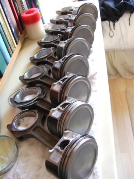

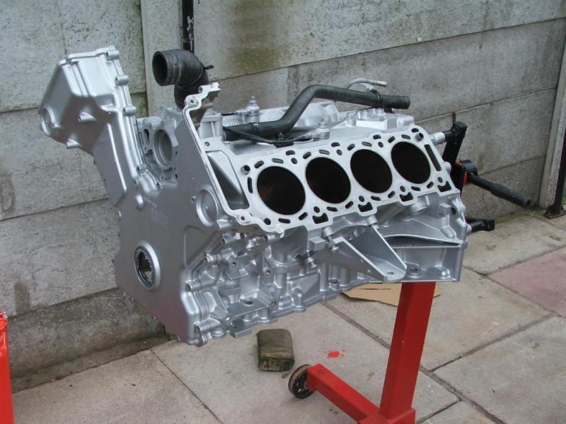

I've rebuilt the whole car, not just the engine, into a brand spanking new bodyshell. It'll be the best on the planet, no idle boast.
Here's some, engine block cleaned, liners re-surfaced (our way, no material removed, just good hatching), new o.e.m mains and big end bearings, (very expensive from Jaguar) new high performance rings and springs. Heads are stripped ready for port and polish. Comparing pistons and valves with an E Type 4.2....Pistons have been balance weighed to within 1 gram of each other. I'm going to use the head gaskets Andre suggested, Cometic.
Engine is "blue printed" so it'll be better than new, mileage doesn't come into it when you freshen the unit to this degree. It's a MY 2002 so has all the 4.2 timing gear. (All new)
Still looking at what TVS supercharger to fit, big bore, low boost, small bore high boost. Whipple or Kenne Bell........
One thing you must do, fit a new oil pump, DO NOT USE THE OLD ONE! My one tip! good luck with the power voyage ;-)
