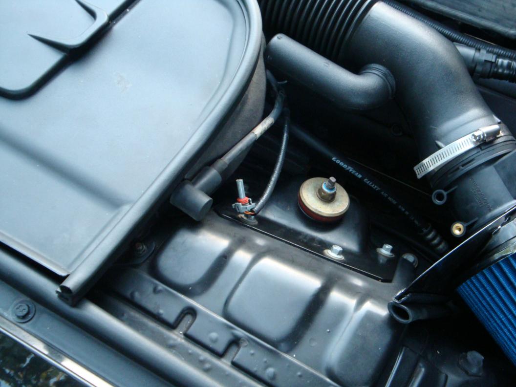

Hey all,
Upon my bi-weekly inspection of my XJR I cam across this random wiring harness that is just hanging with no place to go??? As you can see it is cylinder like in shape with 3 small female holes inside of it. I have searched the engine bay for at least an hour and can't seem to find where it belongs. Any ideas???

Did that car have air susp. On it? It kind of looks like the sensor that clips ontop or the air shock. Since it's a 98 thoes shocks are expensive and people bypass the air. If not since it's by the shock it could go down to an abs sensor

Well, I don't believe it is or was equipped with the air suspension package?? There is not another harness like this equipped on the otherside of the shock tower... The harness is only about 6 inches long before it branches off and splices into the main engine wiring harness coming out of the fire wall. Thanks for the suggestions though...
Edit: DKing, you are correct. I just searched around a little more and found the other harness stuffed away on the other side of the shock tower in array of other wiring harnesses. I'm a bit baffled to be honest with you... I don't know much about the air suspension on these cars. Do you have a personal opinion if it's better than the standard strut/shock spring setup? Is it reliable? Does this mean the rear shocks, if they have not been replaced, are equipped with this air suspension package? What do you suggest I do?

they are the controllers for the "CATS" active suspension, they have two settings, you activate the sports setting via the sports mode switch, the bcm (body control module) does the rest, firms the ride up going into corners a treat, the little orange washer is the seal, do not loose it. Its an electrical signal to the valves in the damper, normal oil...
The system is not air, later x350 XJ's have the air system, the coil over shock system of the x308 is far easier to tune up if wanted. Lowered springs, 30mm on XJ 15mm on XJR are available, as uprated dampers, although the Bilstein are a very capable damper, considering its 1.8 tons....
