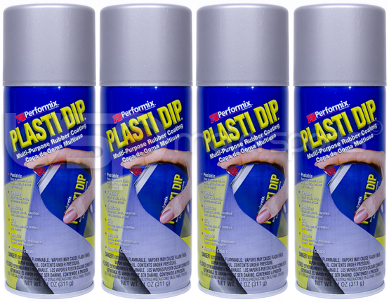

If you want to go cheap with a removable result, get aluminum colored plasti-dip spray, i got mine from dipyourcar.com. You can spray your wheel with a durable rubber coating and if you don't like it it will peel right off leaving whatever you painted in-tact.
I am a big fan of powdercoating as well, I have some cars that I have powder coating nearly everything I could unbolt - but this works great in a pinch and yields excellent results.
