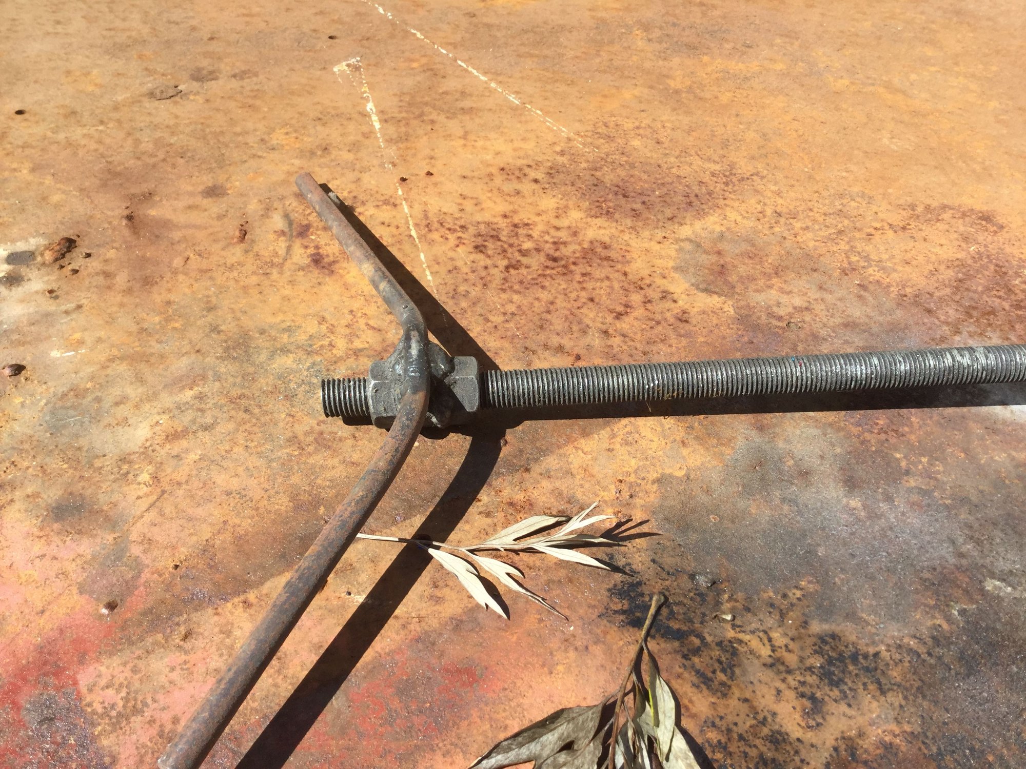

I made one out of a piece of threaded rod, 19mm/ 3/4" with 2 nuts welded together for increased bearing aera and a couple of galvanised 2" square 3mm washers welded into a unequal L
The top of the rod needs to be cross drilled to accept a 6mm roll pin.
The roll pin seats into a depressed slot in the top housing.
Get some long bolts to suit the thead of the seat pan bolts to facilitate realigning the pan when refitting.

Old Sep 18, 2017 | 05:56 PM
Robman25's Avatar
Joined: Aug 2017
Posts: 817
Likes: 193
From: Auckland
Old Sep 18, 2017 | 07:17 PM
hispeed42's Avatar
Posts: 474
Likes: 196
From: Gardnerville, NV
That will do the deed and at a much lower cost than buying the official tool.

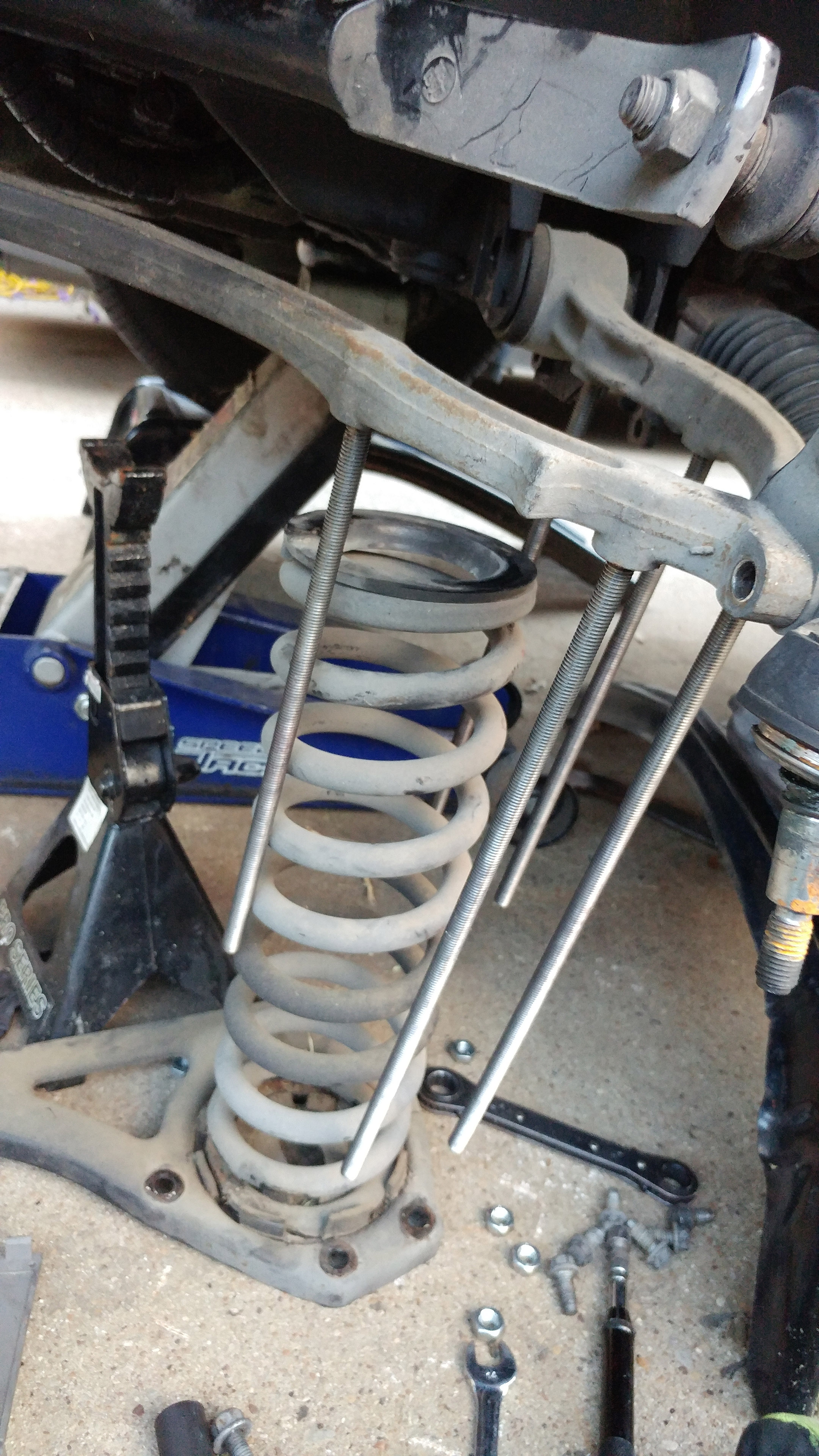

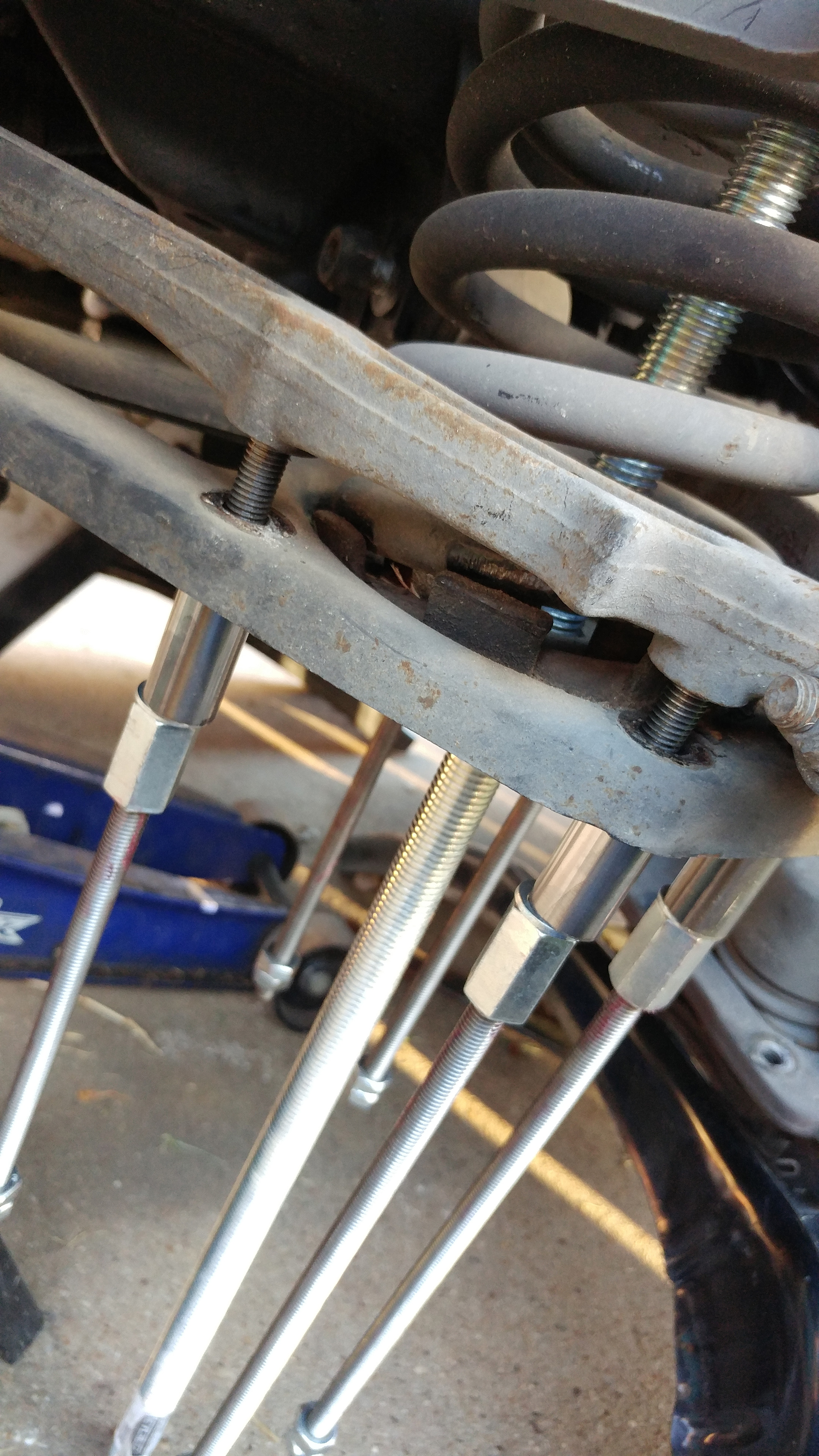

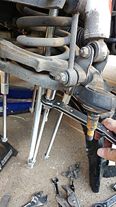

I chose the 6 - M10-1.5 threaded rod option.
It took a few days for Grainger to get stainless steel threaded rod in.
I cut it up into 6 12" lengths.
I finally found the various nuts I needed at Elliotts hardware in Plano-TX.
I decided to use coupling nuts because the length of the nuts would give me much more bite. I didn't want to chance a regular nut fa20iling under that kind of stress.
I used a length of pipe and cut it into 2" lengths.
I removed each bolt one at a time and replaced it with the threaded rod/2" pipe length/washer/coupler nut.
Then I just backed off each nut about 1/8" at a time and worked my way around the 5 rods until the spring was uncompressed.
Took about 20-30 minutes.
Ignore the large threaded rod in the middle. I was going to build the center of the spring compressor tool, but the other option looked easy enough. I just left that rod in there. It's just setting in there anyway.
It took longer to cut the rod and chase the threads than it did getting the spring/cradle off.
