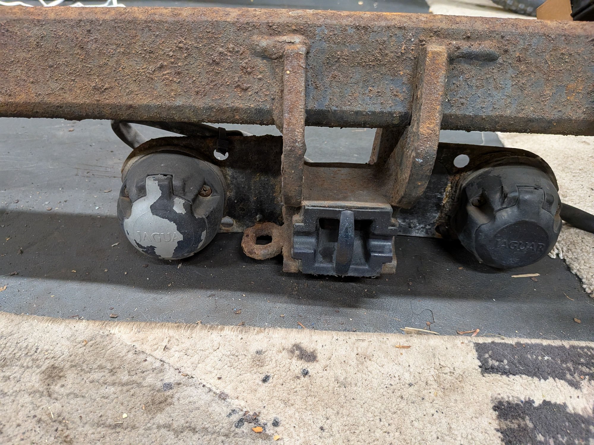

I've been looking at the tow bar on the back of the Daimler for that last 18 months, wanting to take it off but not wanting to start the job. In almost 50 years on the road I've never needed a tow bar, so I won't need one now. Finally, a couple of the bumper cover mounting brackets broke and the cover started sliding backwards and forwards. I needed to take off the whole bumper to repair it so now's the chance to remove the tow bar.

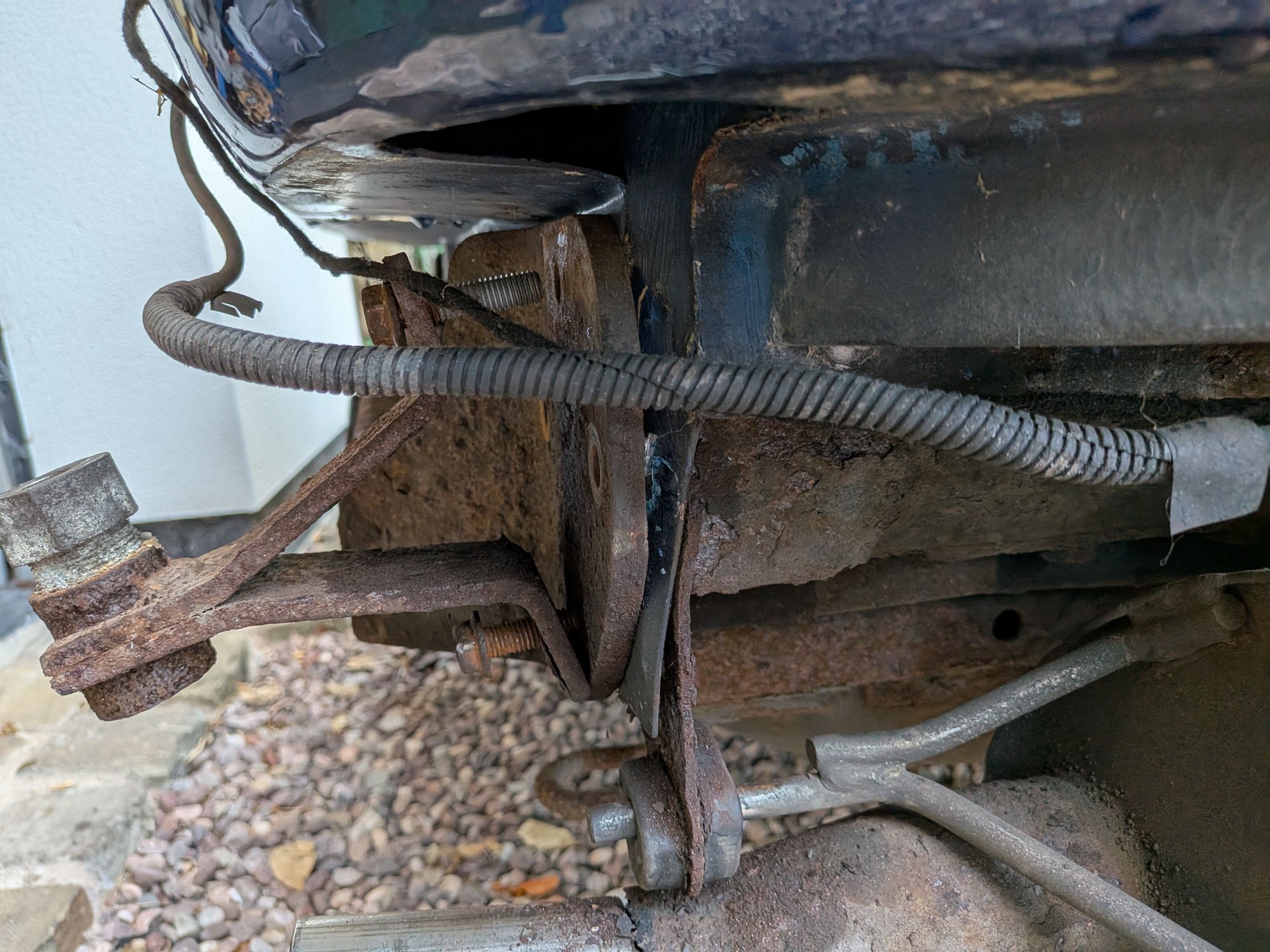

I wish I'd re-read my post from three years ago when I removed the bumper from my first XJ8 - the same problems occurred again. A couple of the post bolts seized and one of the long mounting bolts had also seized onto the thread insert on the bumper beam and just spun round. Eventually brute force got everything off and I could look properly at how the tow bar was mounted.
It uses the four bolt holes as the original mounting post and it's reinforced inside the boot/trunk by an angled support which the two of the bolts fix through. In addition, there are two arms which extend into the box section behind the mounting for the posts. When installing the tow bar you use the bracket which reinforces those arms as a template to drill two holes into the box section so two bolts each side can be threaded through to fix the arms.
The original mounting posts are replaced with two sturdy arms which contain the same aluminium collars as the standard posts and the original long bolts fix through those and into the bumper beam.

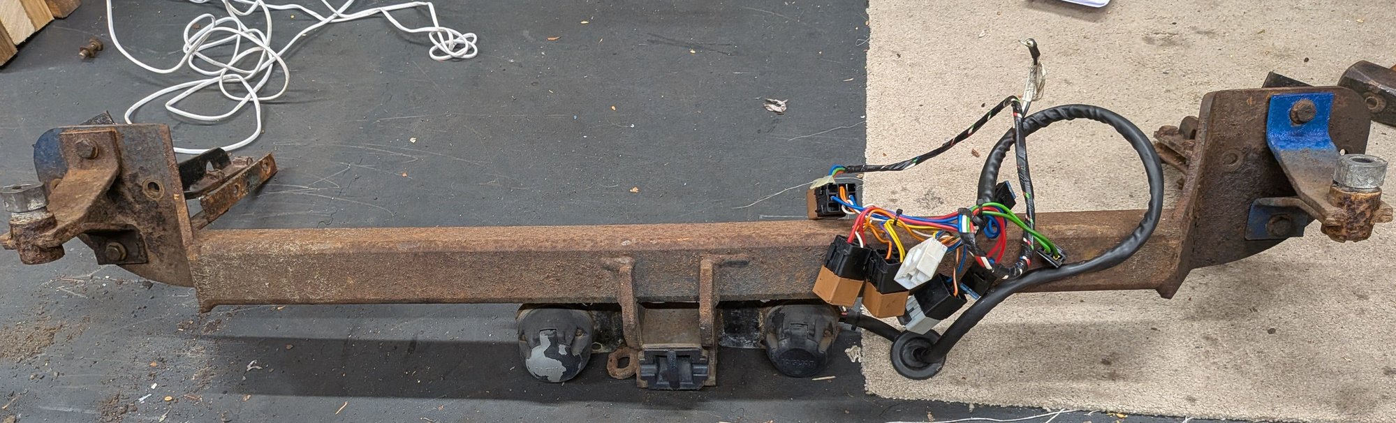

There's a whole bundle of electrics which are threaded into the boot and connect to the accessory power supply, an earth and to a yellow multi-connector. The loom includes four relays and three 15A fuses.
I've written this post for two reasons. Firstly, it will act as a guide to me or anyone else who might install a Blink two bar. Secondly, I'm very happy to let this go to someone who'll use it if they pay for the postage and maybe drop me a bottle of whisky for my efforts. It's big and heavy so probably only of use to a UK based owner. You'd just need to source the actual removable tow hook as that never came with the car. They're available and out there. PM me if you want it.
Photos below - you can see why I wanted to treat the rust.
The full kit - electrics and all:
One bolt left in...
A close up of the mounting post
And a side view (post almost off)

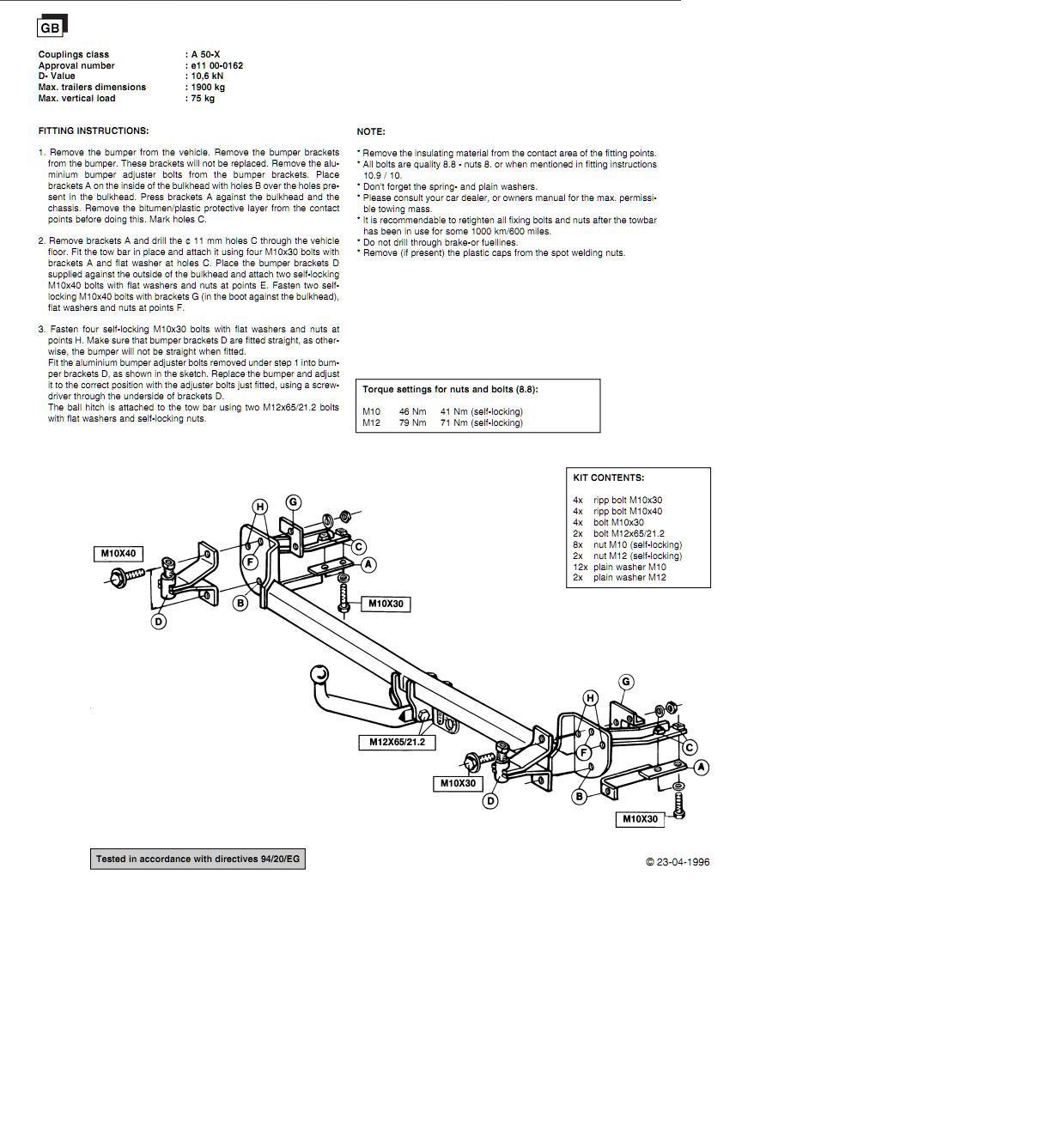

The tow bar was actually made by Brink who are a top manufacturer. I have somewhere the original Jaguar fitting instructions in PDF. The car is actually quite a capable tow vehicle the only weakness being the fragile ZF5HP24 gearbox. I was always wary about that when towing and used to baby the car when towing anything particularly heavy.

If you happen to be able to dig out the PDF it would be great.

If you pm me your email address I’ll send the PDF over if I find it. It may well be on my old laptop which is where a lot of my Jaguar and JTIS stuff is.
