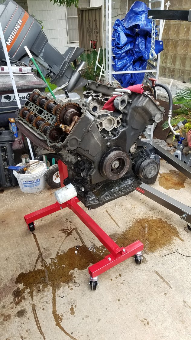

Update:

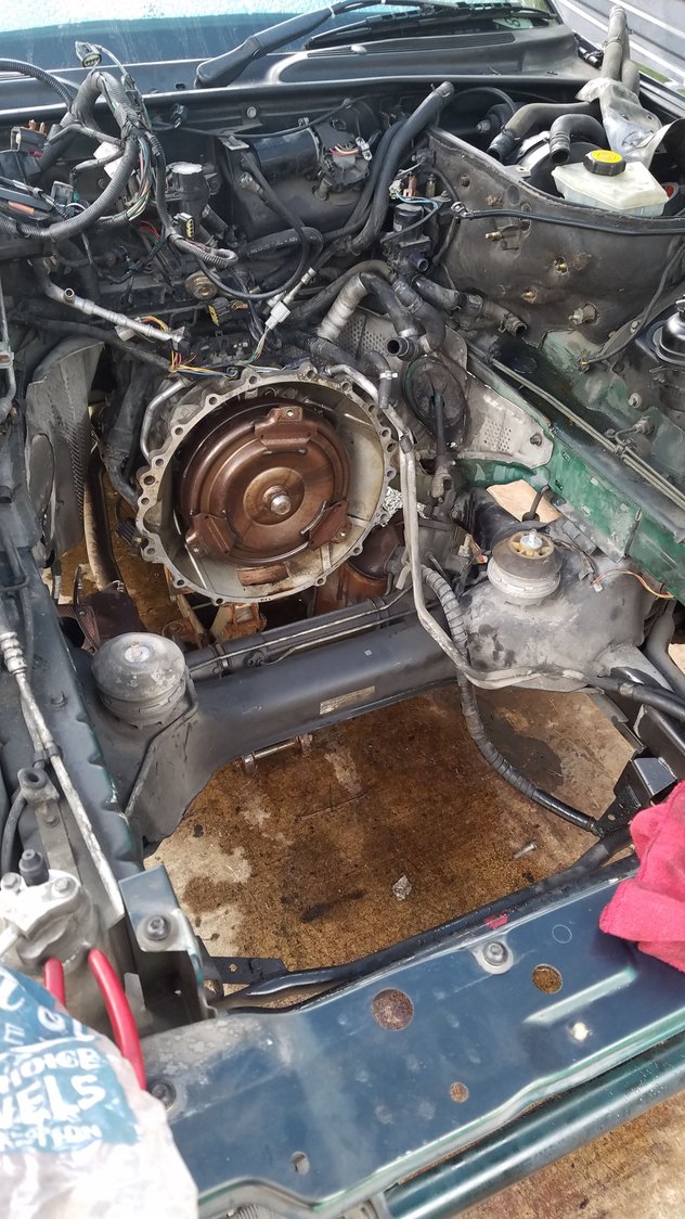

As of today Thursday the 27th of June the engine is sitting on the ground and I think is a now Long Block as I have removed all the accessories. Pictures following. My question at the moment is What is the best gasket set I should get to put my engine back together with.
dirty, nasty,
pressure wash tomorrow

I've copied the latest post from your Intro thread to a new thread in X308 forum. Now you have got to the engine removed stage, this is the place to post technical questions.

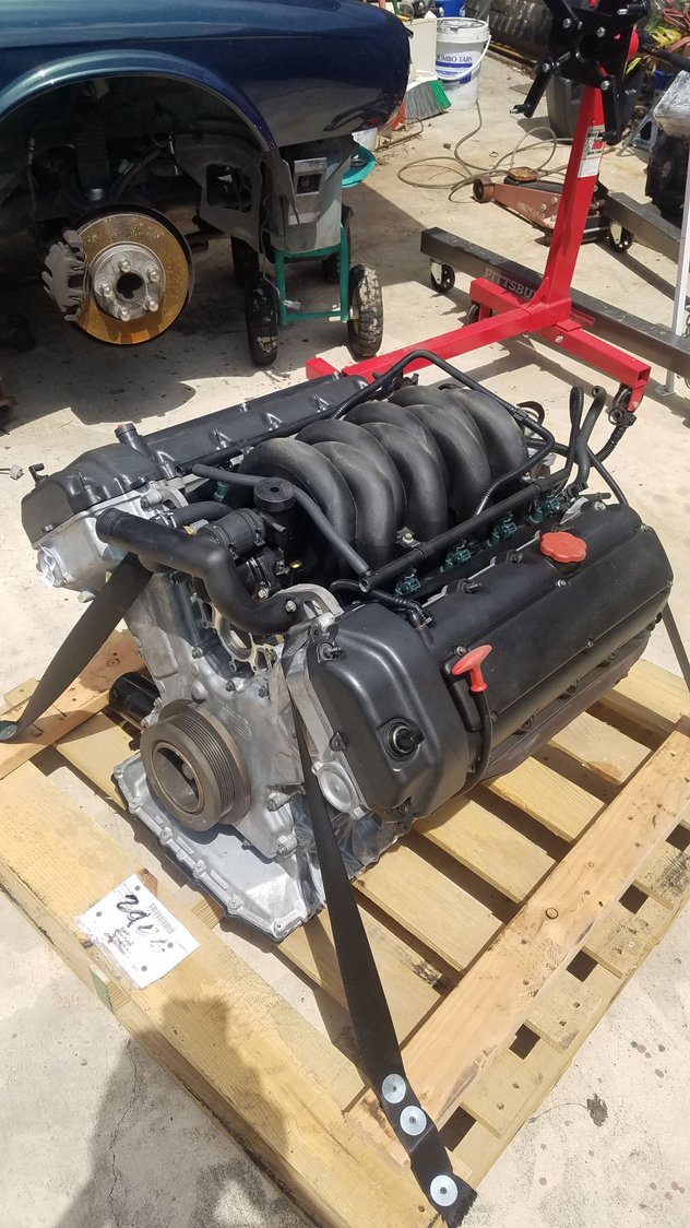

Default Here's my engine.
I'm very pleased with the engine I received this morning. Check it out.

Wow. That looks nice. Who did the rebuild?
Old Jul 13, 2019 | 10:19 AM
Ken Lopour's Avatar
Joined: Jun 2019
Posts: 17
From: San Antonio TX
Hi AJ16er,
It was Sharper Edge Engines out of CA.
It's so pretty it's scary. Makes you wonder how far they went for 3200.00
I am very pleased though, started attaching the other parts last night and I can,t find anything so far that isn't carefully put together.

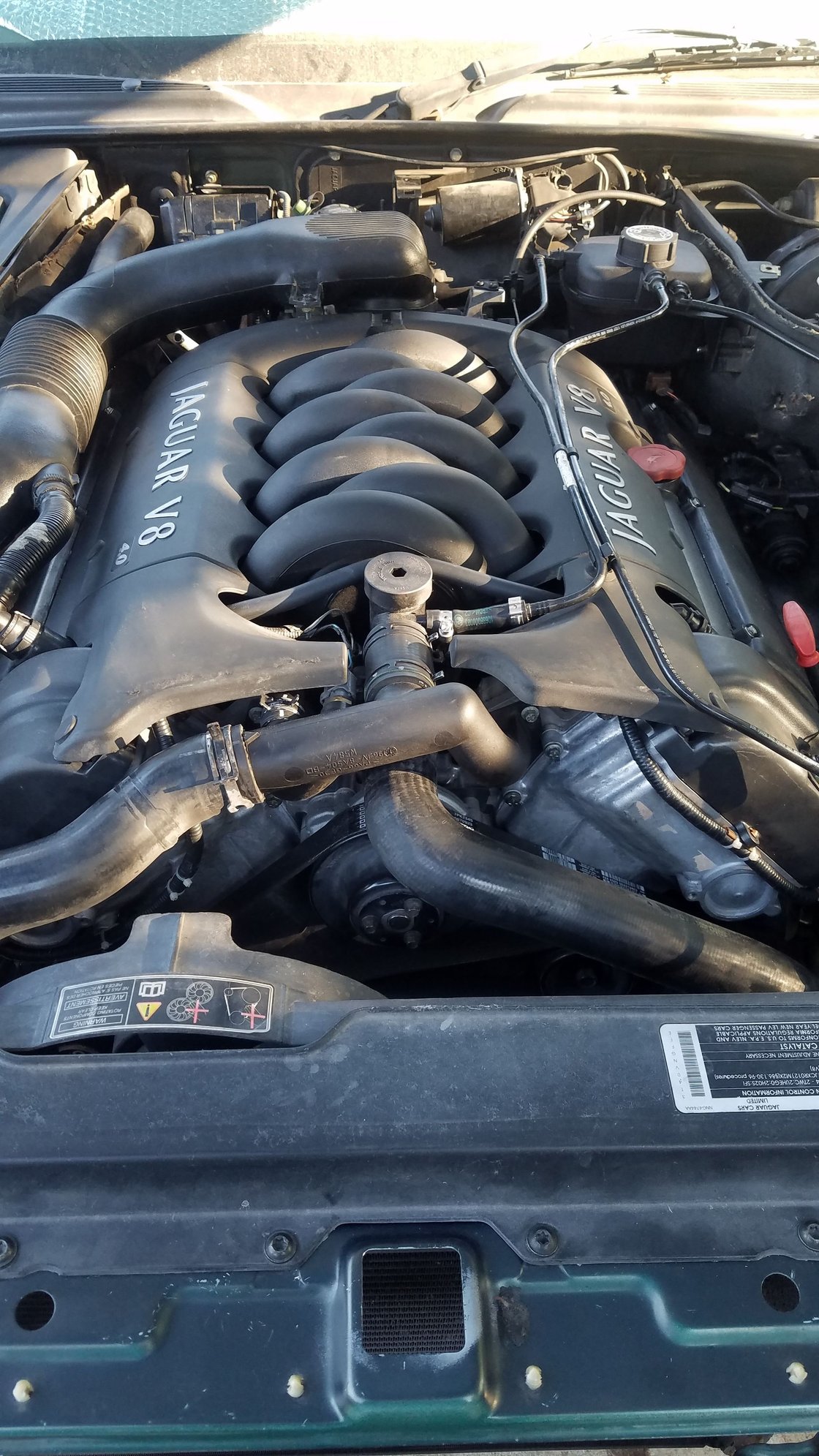

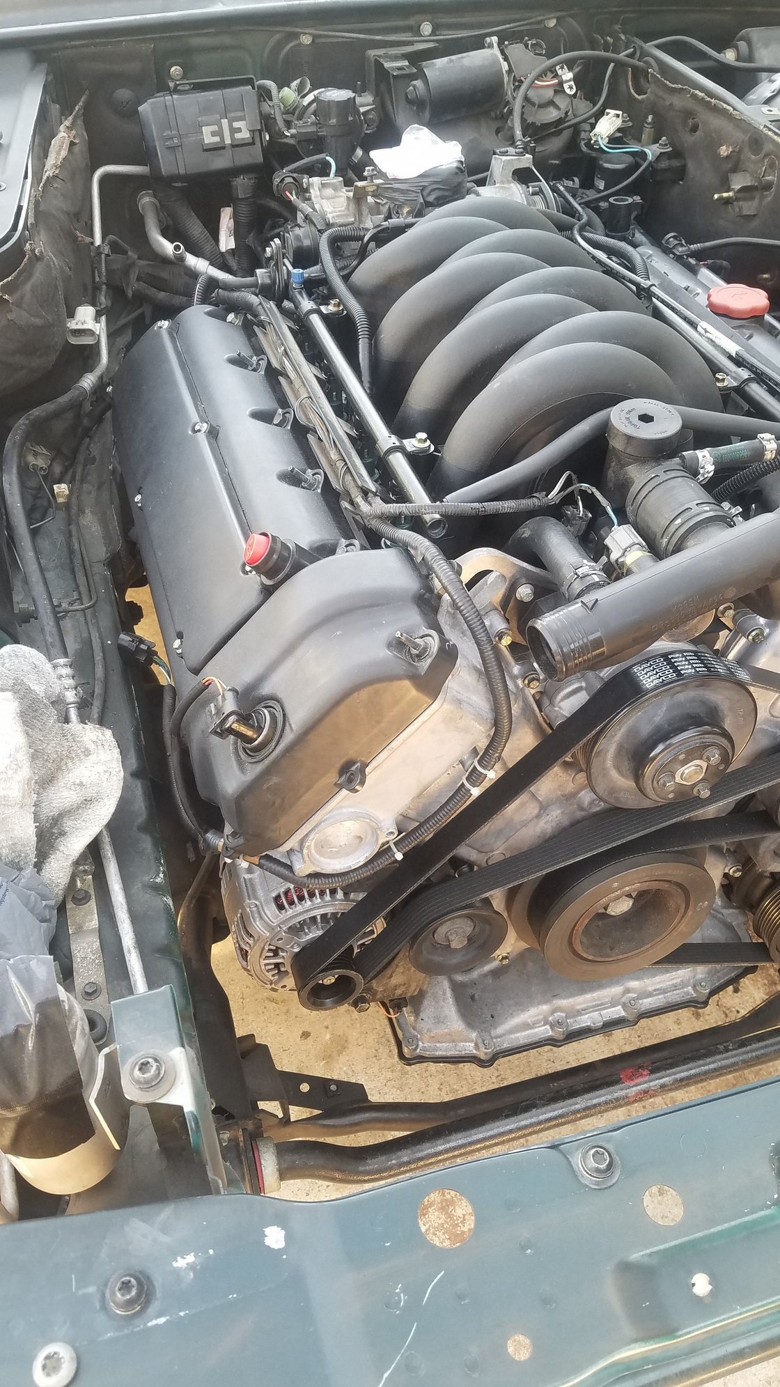

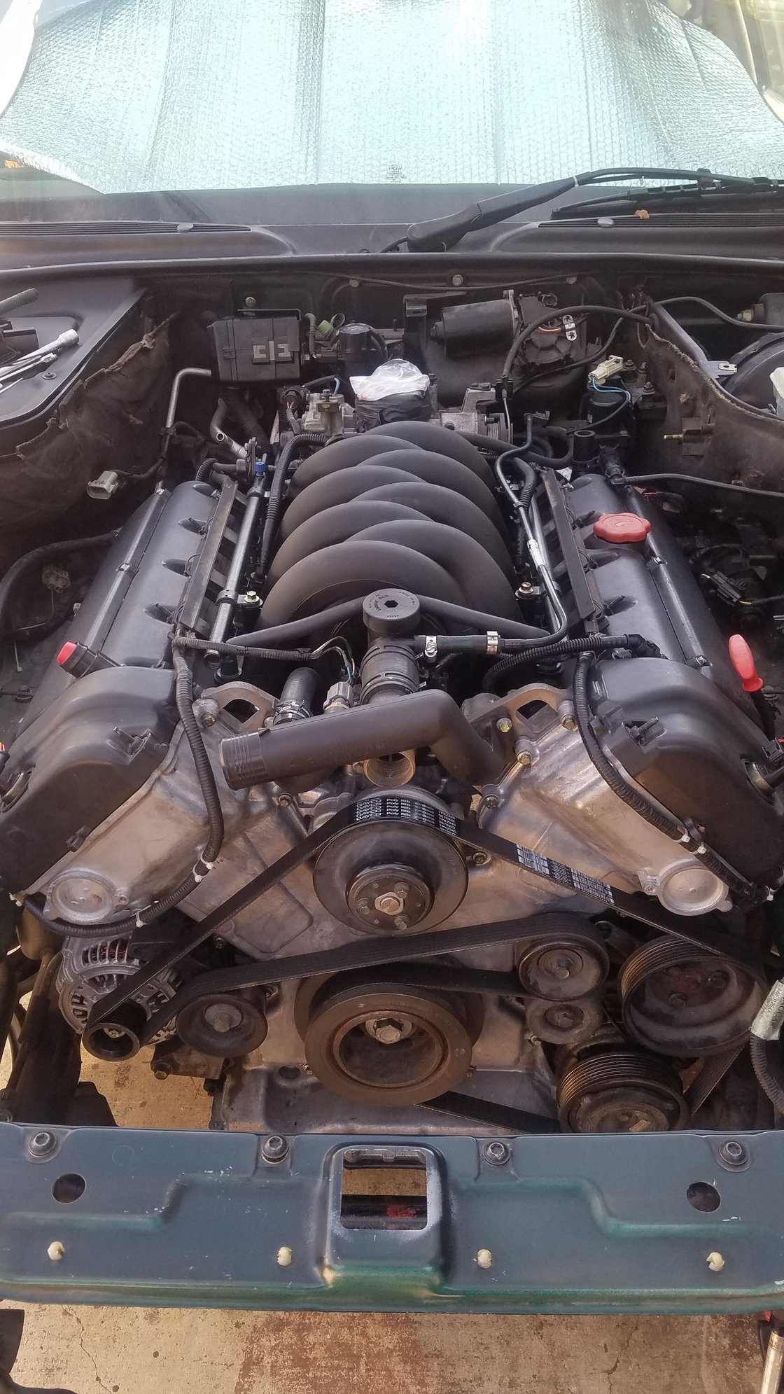

Default Update: This weekend START UP
Well it's been an interesting rebuild. I finally finished the engine. Topped off the fluids and will start her Saturday. Have to go on a service call tomorrow so it will be good for everything to seep into the crannies ,
but here are some picts.

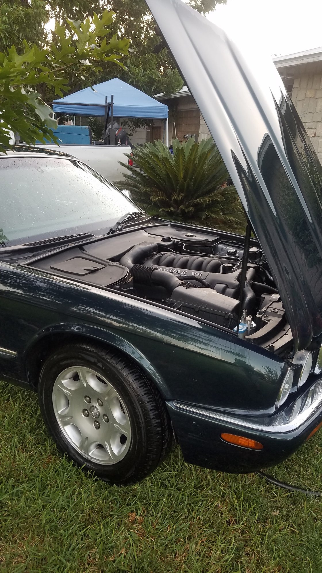

Thumbs up Nice Kitty........
Update:
Thanks to all those who posted thoughts, hints, wisdom and how to's. I turned the key counted to 10 and hit start. It cranked coughed and started! Died..... Held my breath, hit start and she caught
ran up to about 1800 rpm then settled down to dial reading of 1000-1100. Temp at 195 degrees according to OBT 11 reader. All my fluids levels checked out right, now just look for leaks. Had
her on the Expressway 80mph just purrin.

how was it bolting up the bell housing to the engine?
Old Jul 31, 2019 | 06:20 PM
Ken Lopour's Avatar
Joined: Jun 2019
Posts: 17
Oohh for a 4 wheel lift. When I was a transmission mechanic for Tom Benson Chevrolet those were transmission bolt up days, any way
I have this 3/8 battery powered impact gun that helped tremendously. I don't think they wanted it to fall out for sure. Ha Ha.
Worst part for sure is if I haft to change out o2 sensors in the future.
Old Jul 31, 2019 | 07:12 PM
pdupler's Avatar
Joined: Mar 2012
Posts: 2,319
Likes: 1,279
From: Fort Worth
Originally Posted by Dutchy
Good Job smooth and easily done
Don't know about Ken's experience, but its actually one of the easier cars to do this way. Some are so hard you might as well pull the tranny with the motor, but there's plenty of room to work around the bell housing in the XJ8. Remember this body was originally designed to accommodate a v12. Just jack the tranny up a couple inches and support it as you lift the motor off the mounts so that it will clear the power steering rack as you pull it forward. Reinstall in reverse. Have to loosen the exhaust to be able to pull a couple of the bell housing bolts and a bit figity working around the tranny cooler and a/c tube brackets. But overall, this engine's pretty easy to r&r leaving the tranny in place. Heck, I didn't even take the hood off. I took the passenger side wheel off and shoved the hoist in from the side. I could gripe about some other things the engineers didn't allow room to work on, but r&r'ing the engine was a breeze.
