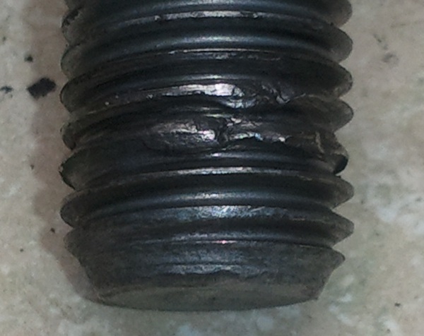

Sean, I called my old mechanic and that's exactly what he said, they used threadlock, and to apply heat. If It's a torque spec'ed fastener WHY did they do that, I hate thread lock, Loctite have so many different variations that don't lock the threads but provide anti vibration assistance and will allow a bolt to unscrew.
So another mechanic friend suggested spraying carb cleaner on the bolt as this might dissolve the threadlocker, so spray wait 5 minutes apply 6 point impact socket an a 24" breaker bar and the handle off my floor jack for a combined 44" of leverage (4" in the handle) it started to move, no drama no bang just slowly giving way to brute force.
I AM SO RELIEVED.
got the bolt out, how did this damage happen, on the end of the thread?
Onward to the cams.. I'M SO WORRIED
Attached Thumbnails Restore oil treatment blows head gasket-roger77-13105-albums-garage-fast-paws-4014-picture-crank-bolt-16902.jpg

Relax- I PROMISE you the hard part is over. The rest is easy comparatively.
You may want to lap the valves at least if you are not going to take the heads to a shop. Also time consuming, but your Jag will thank you for it.
