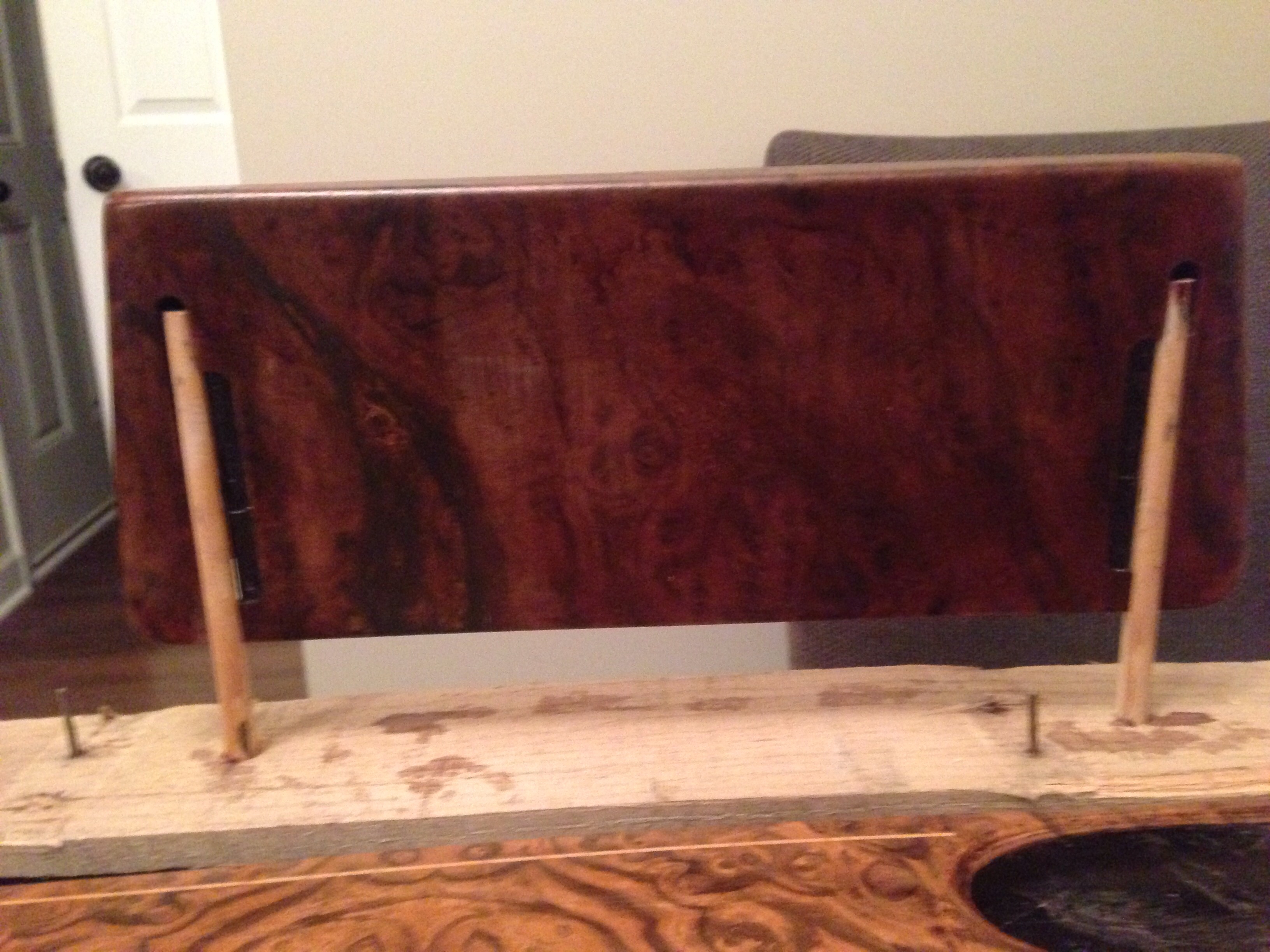

Default Pic 4
I made a jig out of a board and 3/8 dowels to hold tray tables for poly
