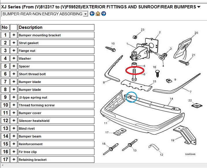

The rear bumper can be awkward to remove because the vertical fixing bolt (item 6 circled in red) seizes in the brass nut embedded in the plastic bumper beam (item 14).
Sometimes the only way to release this is breaking the mounting brackets (item 1).
The last mounting bracket I purchased from Jaguar about two years ago was £38. British Parts UK list them at under £39 each now.

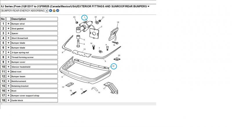

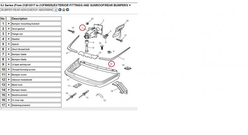

The US bumper is attached with a pair of substantial energy absorbing Struts (item 1) supporting the Bumper Beam (item 12) which I understand is made of aluminium:
The UK bumper is attached with a pair of solid composite (looks like glassfibre / resin) Mounting Brackets (item 1) supporting a plastic Bumper Beam (item 14) with brass screw inserts for the bolts (item 6):
The Bumper Cover and trims are the same on both assemblies.
