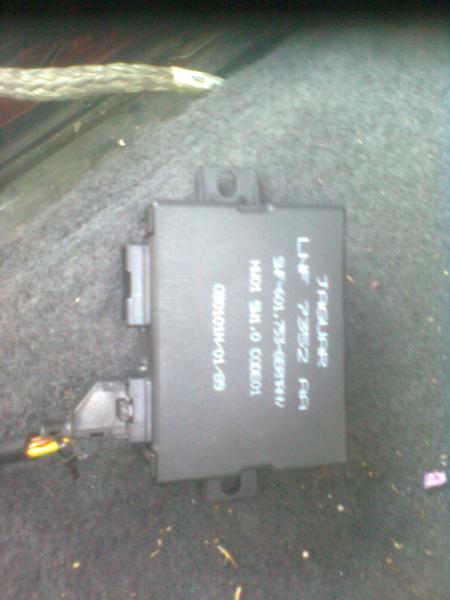

Hi everyone,
My car, Jaguar XJ8 1999, has reverse parking sensors. However they don't work. So trying to fix the problem I found the following: All the sensors are well connected to the Reverse parking aid module (part number: LNF 7352 AA), however the second conector of this module is not connected to anything and I couldn't find any place to connect it.
I would really appreciate if somebody could show me where it must be conected.
Thanks in advance!

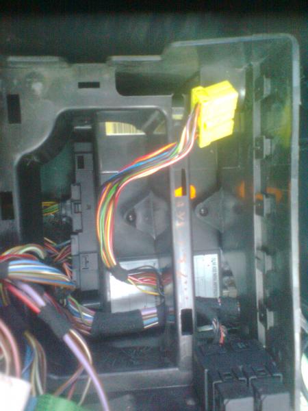

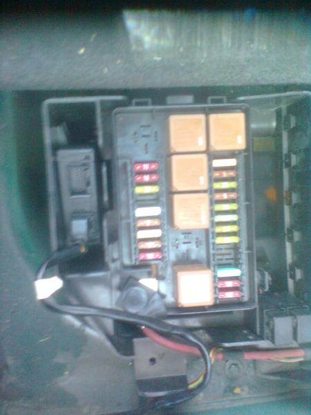

Dear Sean,
Thank for you help. Now I think I am closer to the mistery. The fact is that on step 26 and 27 the harness (yellow) is different so that I cannot connect both. I have done some pictures... Could you help me to solve the mistery?
Thanks a lot!
