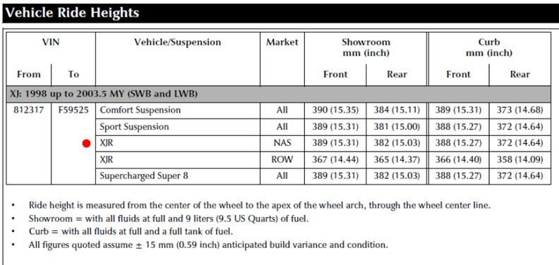

Not sure what specs you are using to check ride height, factory specs for a North America Spec (NAS) XJR are 15.27" front 14.64" rear, with a full tank of gas, measured from the center of the wheel vertically to the apex of the wheel arch. (15.31" front/15.03" rear with just 2 gals of gas).
What measurements are you seeing?

I'm seeing about 15.7" in the front and 14.7" in the rear. That makes me feel better as it is about .4" of an inch off and I expect it will settle a little. Also due to the old lower bushings being worn the wheel camber is set almost all the way in causing the wheels to go inward at the bottom with new bushings. Once I get an alignment that should also slightly lower the height and reduce the distance from the wheel center to the arch. Right now it is riding on the outer edge of the tires it seems. Thank you for the info! We will see how things measure out after alignment.
