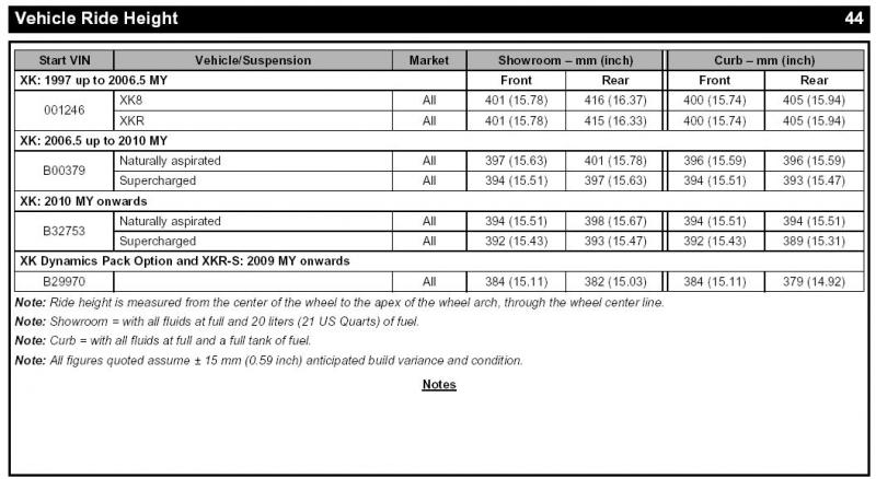

Finally got the front suspension back up where it is supposed to be. After previously installing new coil spring pads and gaining a half inch I was still 1-3/8" down from the spec ride height.
I assumed that after 15 years and 176k miles the front coils were tired and sagging. Setting them side by side with a new one on the bench tells the story (pic #1).

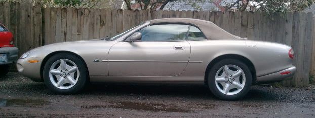

Ride height is on spec at 15-3/4" wheel center to fender arch (pic #2). The car sets more level now (pic #3 vs. pic #4).
Now with good spring pads and new coils up front the difference in ride and feel is significant; firm but not jarring and no more squishy feeling and more stable. Still have a bit of pull to the right but that may be due to the tire wear at this point.
