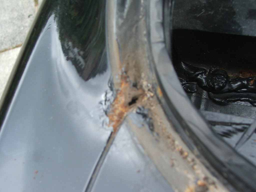

Second favourite is the lower base of the rear screen. Where the panels meet is a water trap under the screen seal. Inside the luggage compartment where they meet is a big glob of expanding foam rubber, with the consistency of chewing gum, this can be fished out with a screw driver, giving the area room to breath, and not trapping water. A coating of wax preservative is in order to protect it from r-u-s-t.

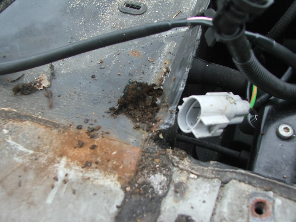

Next is the scuttle/inner front wing join, filled with that crappy foam, I think drilling and squirting wax oil in there is one possible way of protection. Using a short drill depth of course.

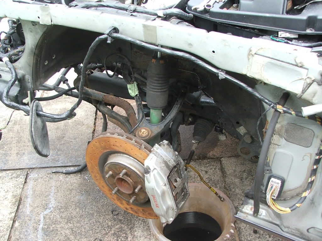

This is a part seldom seen - but it's scary to think a load bearing chassis/suspension section can be affected by rust - the lower rear suspension carrier.
It's work to bring it up to scratch, but another area worth checking..
Finally the inner wing behind the shock is another weak point, difficult to get at, but easy to keep clean and clear of mud pies.
