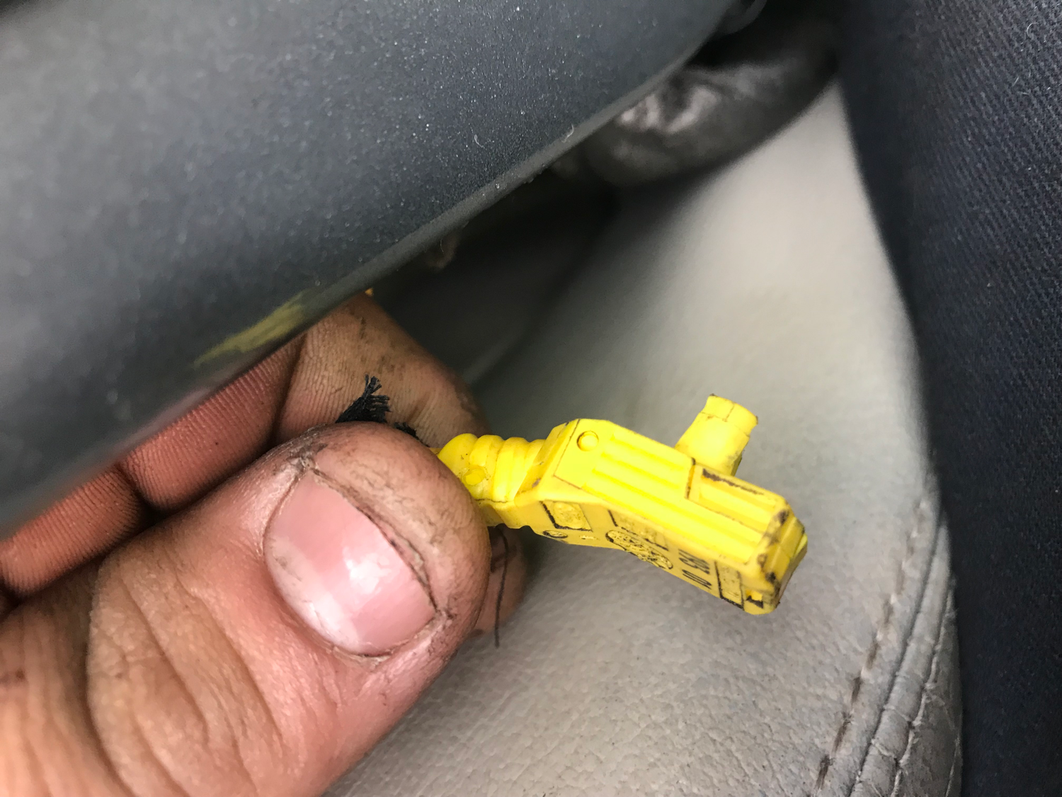

I have a seat belt warning light on all the time. I took it to a Jag mechanic, and the test showed the fault was in the retractor mechanism on the driver's side. I bought one from an aftermarket source, and I opened up the pillar covers on that side. I found that the little yellow plug had been taped in place in the retractor. And it looked "bent."
I then plugged the plug into the "new" retractor, and the light went out and then back on.
I am now guessing that the "plug" is broken, but I am having no luck finding one. One source I found said I needed to buy then entire interior wiring harness, to the tune of some $3,000! My next choice is to start looking for a Jaguar used parts place that would cut off the "yellow plug" and sell it to me.
Am I headed in the right direction? Does anyone out there have experience with this kind of problem? Any recommended sources for parts?

Sorry for the wrong labeling. I don't have much backup info for this car. The question is: Will a bad SRS Plug cause the light to stay on? The diagnostics said the problem was in the reel in the pillar, so I bought a used one, and the problem still presented itself. I also noted, and your can see in the pictures, that the plug is not "straight," and it was held in place during the last installation of that reel with electrical tape wrapped around it and the plug.
Where do I do next? Is it worth asking pigtail.biz for a replacement plug?

Brutal: What you say matches with what the data tells us here. The code said it was the pretensioner, which had supposedly happened before, and it was replaced. I got a new one and was going to do it myself, but when I noticed that the "plug" was taped into place with electrical tape, I put the plug into the "new" one. The dash light went out. But when I moved the plug a bit, it came back on. This is why I believe, and now my mechanic now believes, we have a bad "pigtail." And so far I can find no source for the pigtail. Do you have any suggestions? Thanks again! Wayne

I tried them, and they came back and said they couldn't do it. I sent pictures, as Johnny requested, but no luck. And I meant "gold-plated" as in anything for Jaguar, or the old Porsches I've got, may look "normal," but they always seem to be more expensive than one would think! Therefore, they must be gold plated, but I just can't see where the gold is!!
