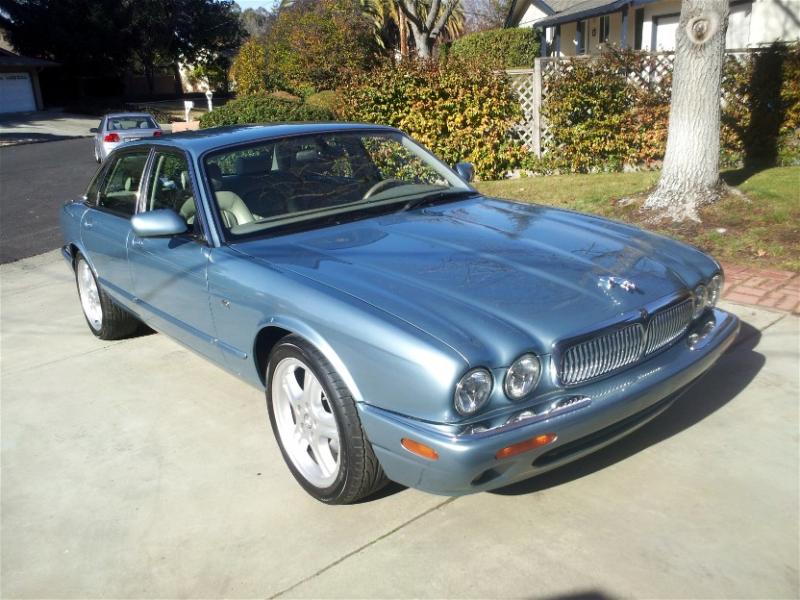

Default Pic
A pic of my pretty kitty
Attached Thumbnails Should I change 10 year old fluids?-2012-01-17-13.27.30.jpg

What a clean car , looks like it just came out of the factory

Yup, she is a pretty kitty. The proverbial little ol ladies car. My neighbors mother bought it, and one year later had a stroke, so they kept it covered and maintained, but only drove it to the mother's appointments. 37K original miles.
Quite the deal at $9500
