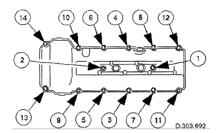

Old Mar 31, 2011 | 10:35 PM
Gus's Avatar
Gus
Joined: Jul 2008
Posts: 11,356
Likes: 2,236
From: Berlin Md.
It is 9 - 11 Nm

Jag gaskets are notorious lor leaking at the rear corners. Especially passenger side rear. Install a new set and torque to spec in order. This is the most important part and most ignored. Can't tell you how many I've seen that were overtightened and leaked worse than the originals.

Originally Posted by Gus
It is 9 - 11 Nm
Thanks,
I assume I can use my in/ft torque wrench after conversion.
Old Apr 2, 2011 | 11:00 AM
dsetter's Avatar
Joined: Jul 2010
Posts: 776
Likes: 215
From: Gilroy,CA, USA
Yes
Torque Conversion Newton Meters to Inch Pounds - Printable Chart - TheToolHut.com
10 N.m is NOT much to most of us.
More damage has been wrought through over tightening than not tight enough, in most cases. It is never right to tighten till it strips and back it off a quarter turn.
