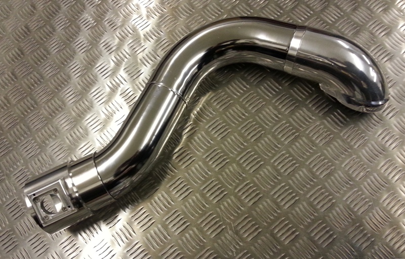

This is a full pipe I did, however I did have to redesign the MAF body as on the 4.2s this type threw up a fault but on the AJ27 4.0s it was fine.... The MAF body would have to be a standard push in type if you have the AJ26 engine

they really do look great, and it's always nice when a part has actual performance gains as well
