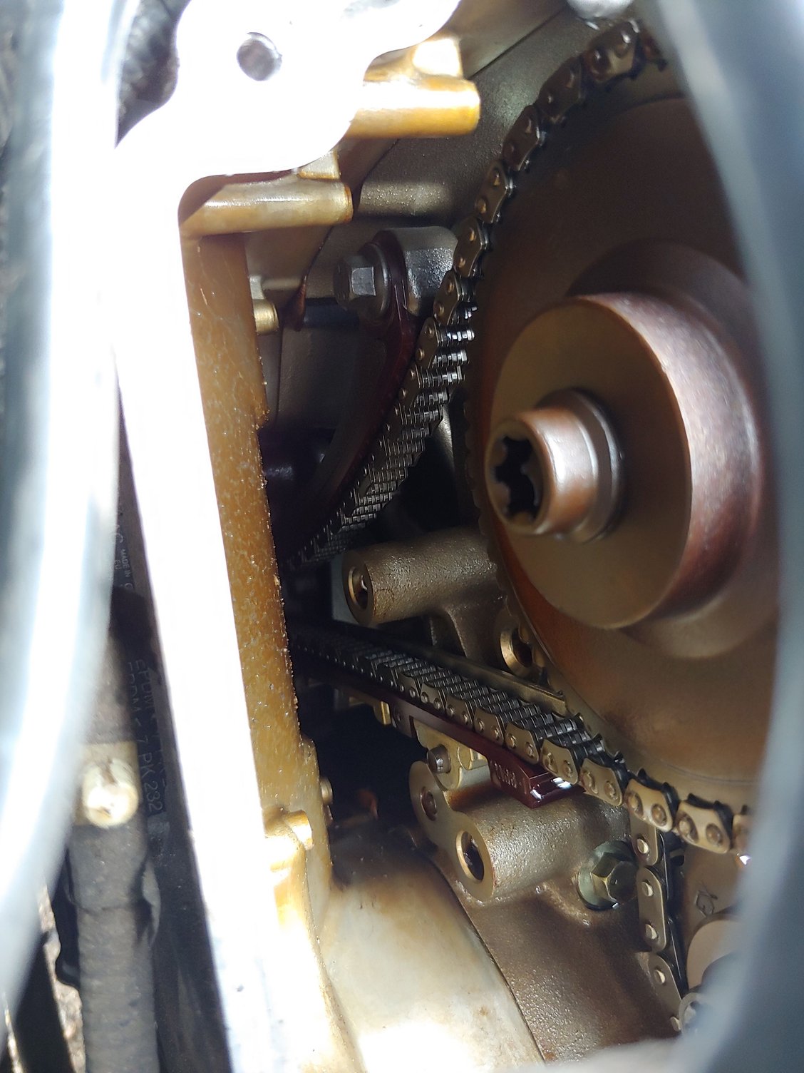

And I do apologize. But I couldn't find any answer on my searches. I have a 2002 xjr 100, 115k miles. I pulled the left side cam cover. It does have the 3rd gen tensioners and Morse primary timing chain. Is the 3rd gen timing stuff supposed to be 100% quiet on cold starts? Mine ticks loudest on cold starts, and gets quiet/pretty much goes away once warm. Oil level is full.
Side note. I had a 2002 xj sport before this, and it also had the Morse chain and 3rd gen timing components. Sounded exactly like this car. And I drove that car daily, except weekends, till I sold it.

I don't know what that momentary triple "knock" is at 18-21. I don't believe it is anything to do with the timing chains or tensioners, it seems too deep a sound. A sound that deep sounds like a crank bearing, but I doubt that is what yours is, you would hear it on override if it was that bad.
But, if you have not investigated to see if you have the later MKIII metal-type tensioners.......you should.
And yes, get that engine bay cleaned

I pulled the left side cam cover a day after I got the car.

Ah yes, I remember now, you have the later "multi-row chain" and later tensioners, you should be golden!
