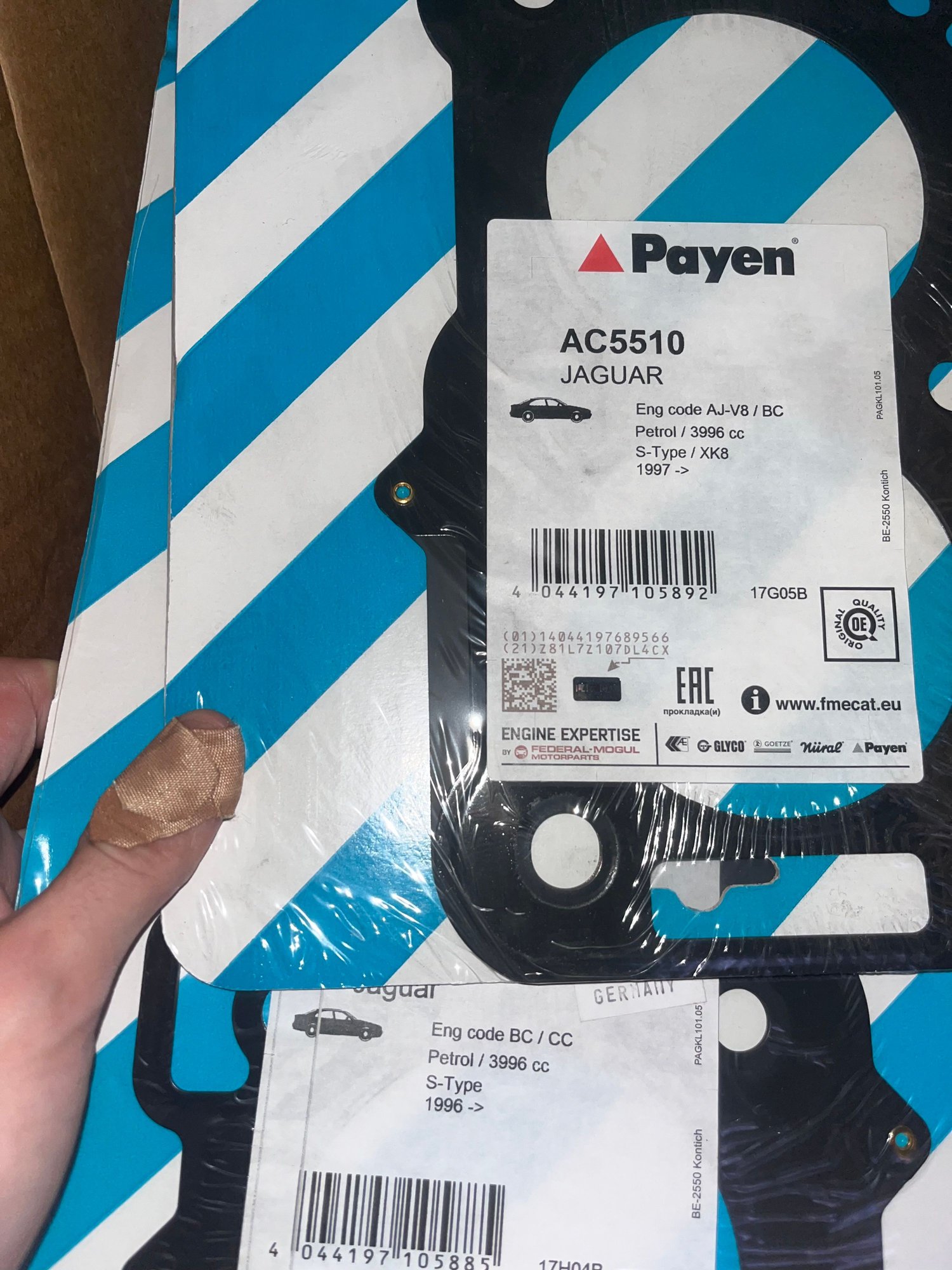

HG came in but not for the 05 XJ8. Is it Normal to say a different car or is this a mixup?

ALL AJV8 4.0 liter engine blocks are the same.
The differences are mostly in the upper sumps and intake cams.
I have a 2001MY S-Type 4.0 (AJ28) engine block with AJ27 cylinder heads and upper sump in my 2000MY XJ8L.
The XL8L had a seized engine and the S-Type engine had a 'dropped valve'.
I just took the S-Type engine apart for the short block and installed good used upper sump and heads from an AJ27 'nikasil' failed engine.
I installed the MLS head gaskets from the 4.2 AJV8 parts catalogue number and used them.
The 4.2 engine has the same BORE as the 4.0, just a longer stroke.
Head gaskets will fit fine. (FORD 3.9 liter head gaskets WILL NOT FIT)
I don't know if the old composite gaskets are being made anymore?
